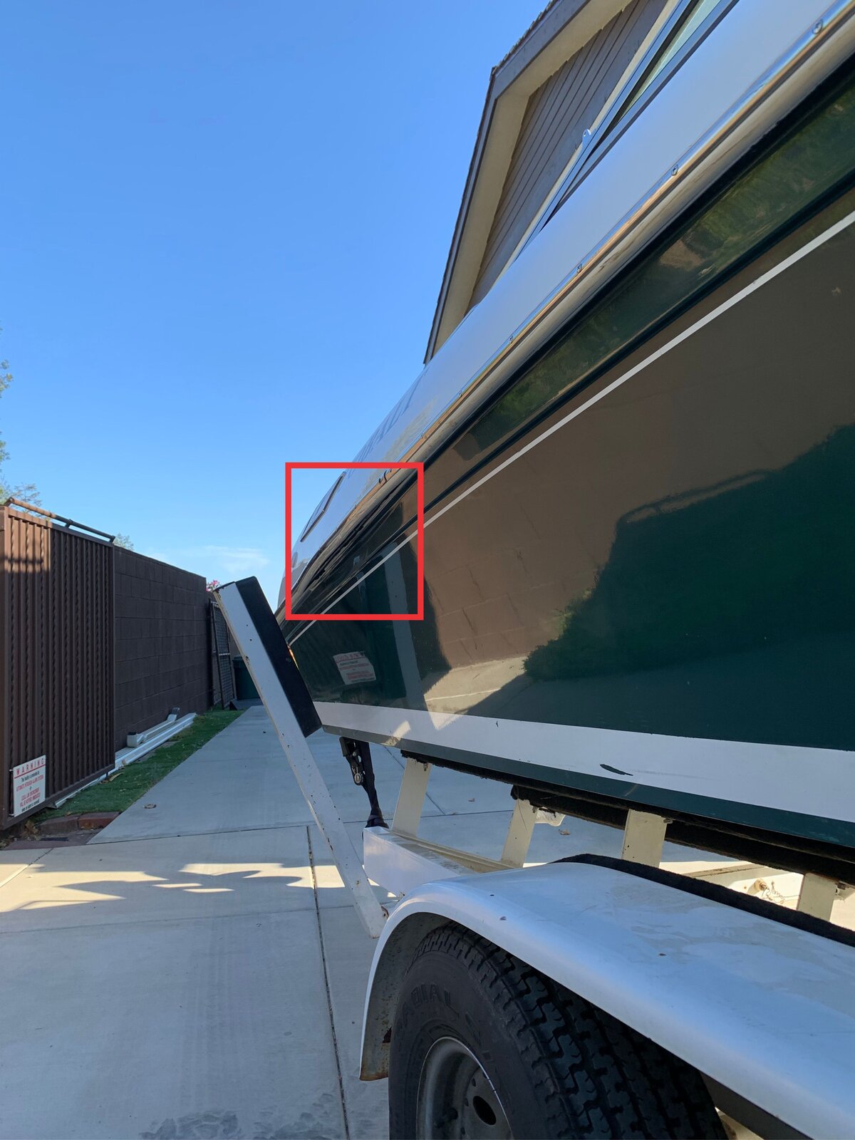

    Found a 41" separation [about 1" separation - pictures attached] on my 1995 COBALT 222 May 1, 2020. Have been told repair is easy and inexpensive to fix without re-fiberglassing over the cracked area??? Not sure I agree, but I haven't fiberglassed anything since 1969 when I was repairing dings in my 9'6" Jacobs big gun long board. Appears to me that there may be additional areas of cracking on port side, but without separation YET. There is a plastic trim moulding covering the shoebox junction around the entire edge at bumper level terminating at the centerline of the transom. Seems like this level would be subject to damage with rough handling docking or loading on a trailer. The trim moulding appears to be one continuous piece by design. I have been told by one of the three boat repair companies I have tried to work with that this trim moulding is not available because the boat is too old. Will confirm with COBALT, but I suspect that may be correct. Any commentary on my problem and the best route back to functionality will be sincerely appreciated by me and my grandchildren who are devastated that we have lost the entire season at our resident So. Cal. lake. I would have thought the pandemic would have been depressing enough. Will keep trying, but right now cannot get an apt. to have a fiberglass repair outfit even look at my problem. To all on the site... Stay Safe and carry on...

    Pretty unusual to see that kind of a separation unless it took a big whack. Fortunately you live in an area with a lot of good fiberglass boat repair places. As for the molding there were 2 types used mainly. One was an extruded rubber/vinyl molding with a stainless insert and the other was/is an extruded aluminum molding with a rubber or vinyl insert. I can't tell from you pics which one you have. If its the rubber it could very well be one piece usually joined at the stern. The aluminum ones were almost always extruded in 12' lengths so if you can find it you would not have to do the whole boat. It's not a hard job and if you are handy at all you should be able to do it.
    Look at www.tacometals.com as they probably have the molding you need and if not they will have a replacement. In any case, you should be able to find something that will get you back on the water.
