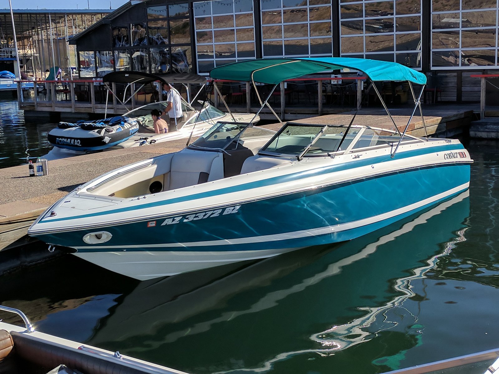

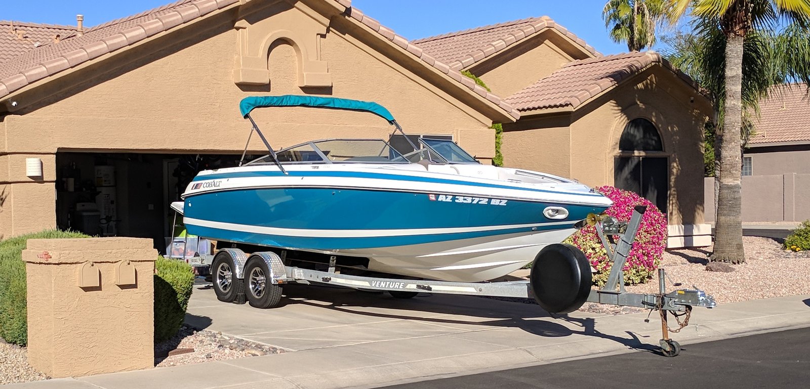

    Got a Carver Sunbrella bimini installed after delivery yesterday, looks pretty nice. I wasn't thrilled about drilling new holes but you gotta do what you gotta do...

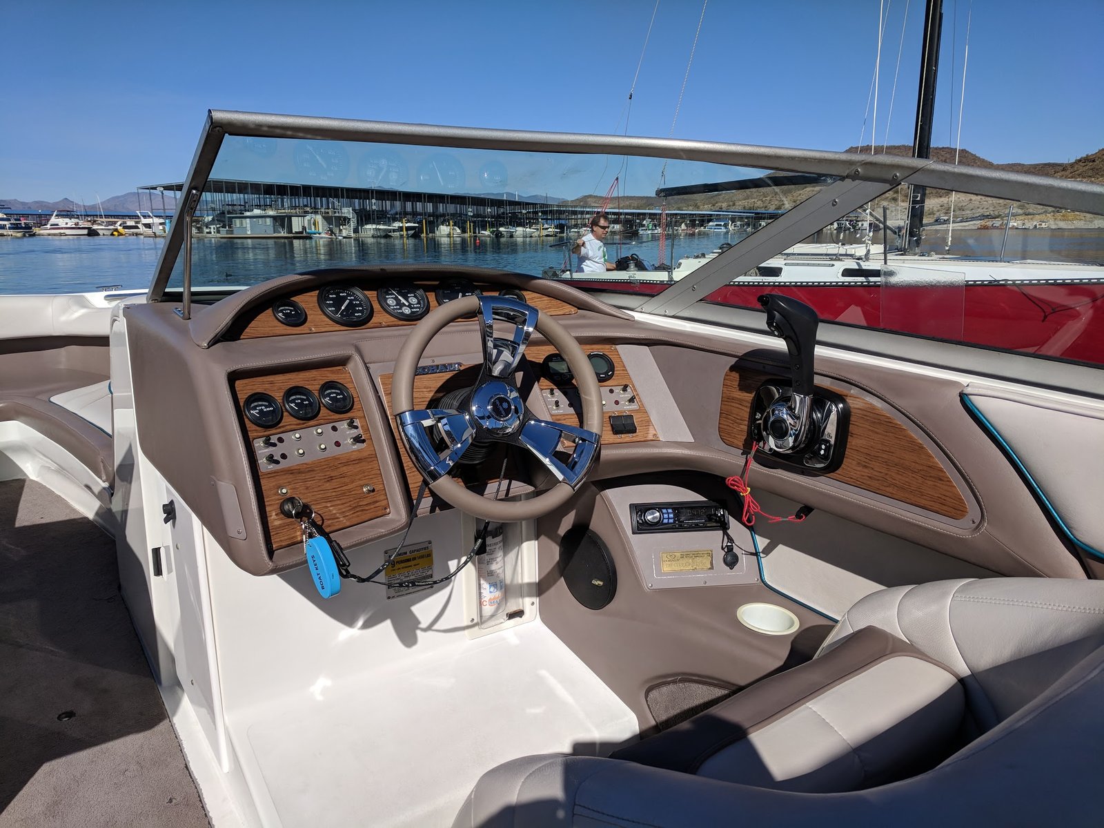

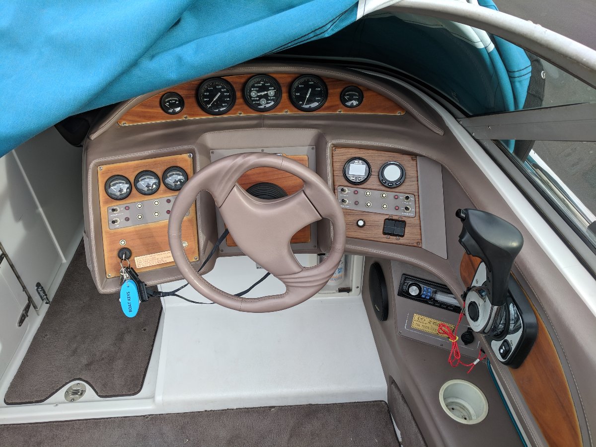

    Interior shot. Engine hatch vinyl isn't the greatest, but it's actually better than a lot of newer boats I've seen. Probably won't worry about replacing until it gets a lot worse. The rest of the interior looks good, rosewood is a bit faded, might have to try and fix or replace.

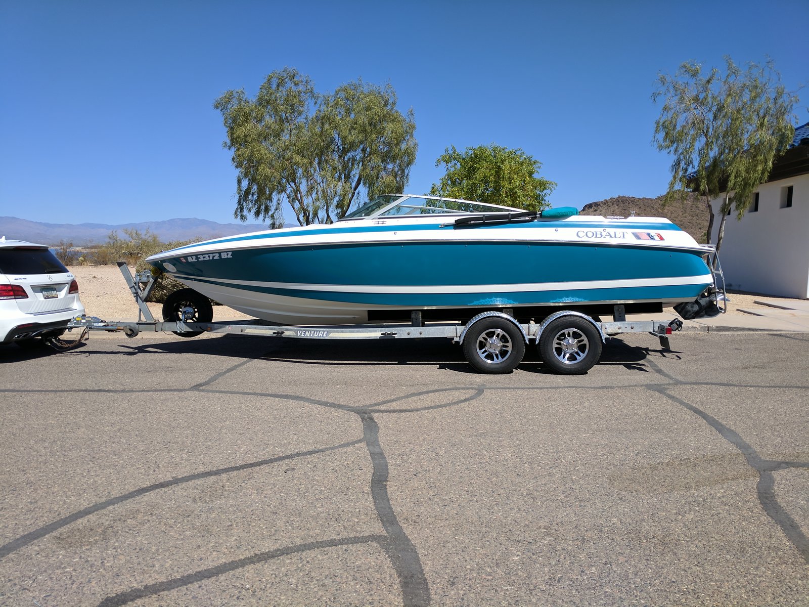

    Got the impeller housing and slave solenoid replaced yesterday and went out for a shakedown run and to do some further trailer adjustments. I went alone in case of problems (reverse of normal, I know...), as I tend to do better problem solving when I can think quietly to myself vs having to try to tell someone else what to do or how to help. She did great! Other than a little bit of belt squeal when first accelerating with a cold engine, no issues. Will replace the belts before next outing. Did a full lap around the lake a close to WOT, measured 54mph on the GPS the one time I checked. Fairly busy so not a lot of smoother water to be found. Felt so good to be back on the water again!
    Ended up moving the boat 9" further back on the trailer, which allowed me to also move it down about 3.5". I'm really liking the position on the trailer, and the axle centerline seems to be on par with the photos of 252's on custom trailers that I've looked at. Will go ahead with bunk replacement now, wanted to wait until re-positioning was done so as not to drill extra holes into the new boards. I loaded the boat onto the trailer twice with the new position, it went on easily and self-centered both times.
    I was a little nervous about launching and loading solo, but I was faster by myself than about half of the groups that were there, so I guess it worked out ok :)

    Pics from yesterday

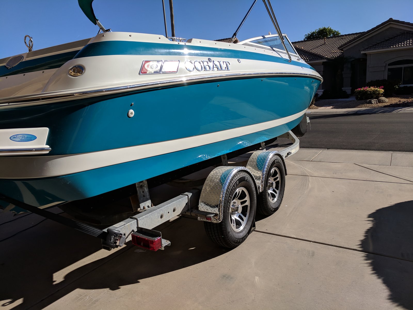

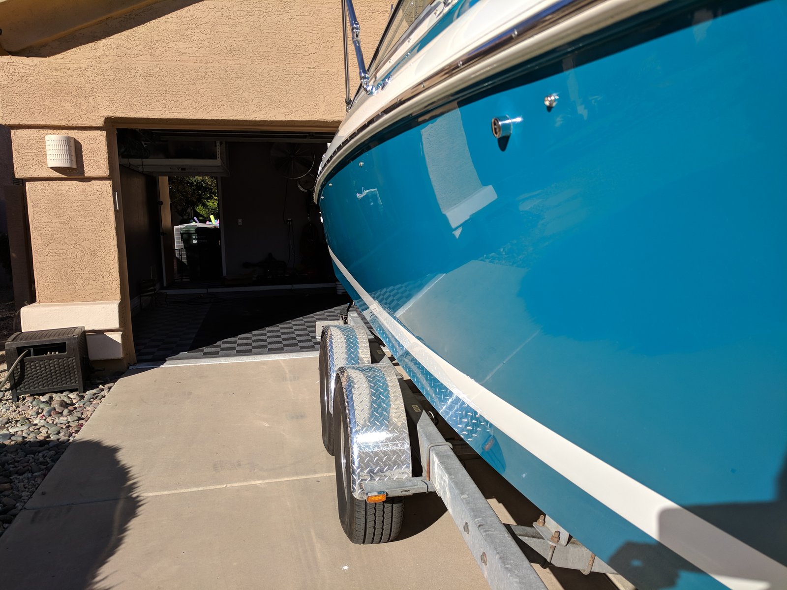

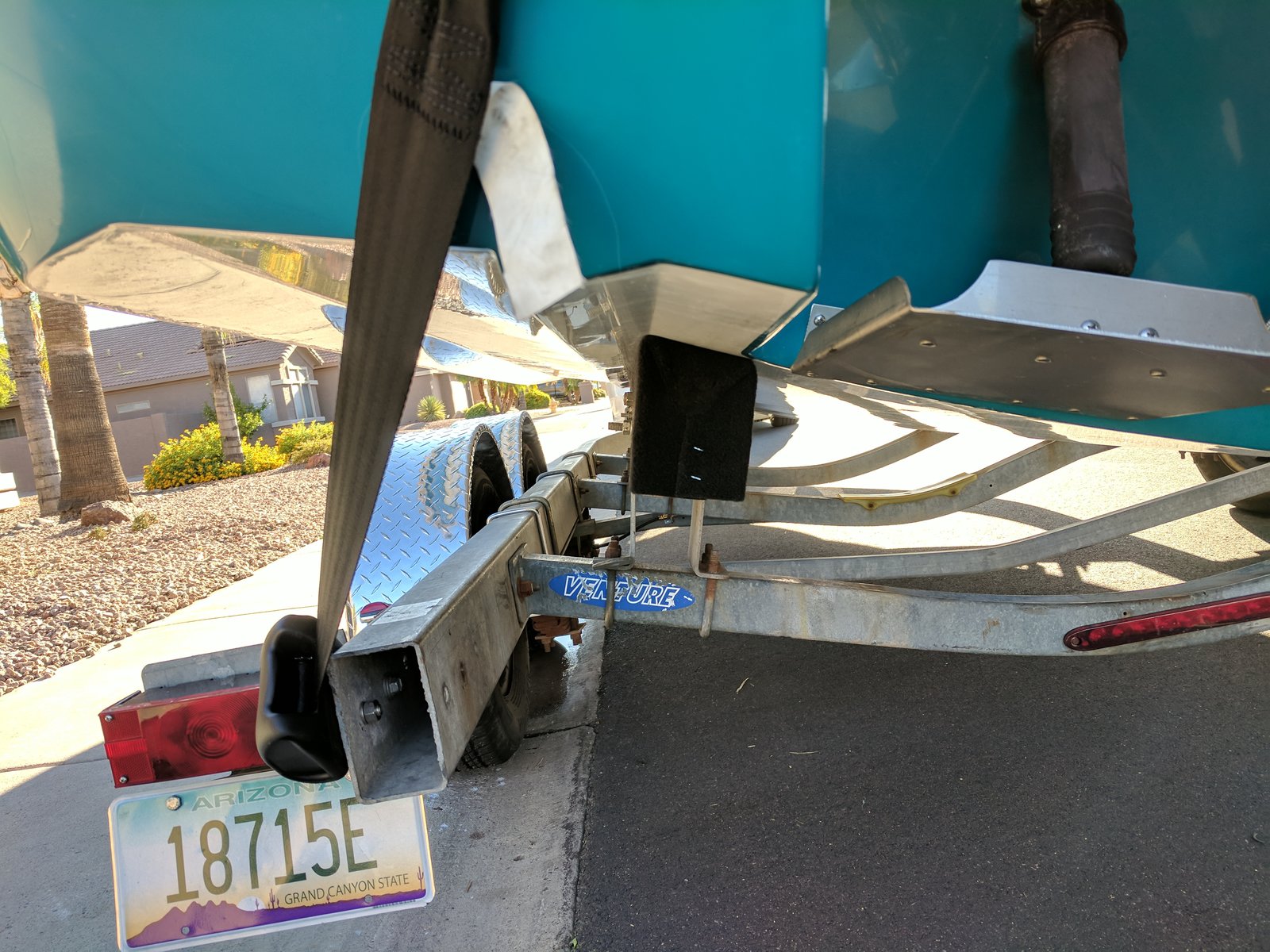

    New bunks, fenders, and LED lighting on the trailer. Part of me wants to try and paint the galvanized wheels with chrome paint, and part of me says just to wait til I need new tires and replace them with some nicer looking aluminum ones.

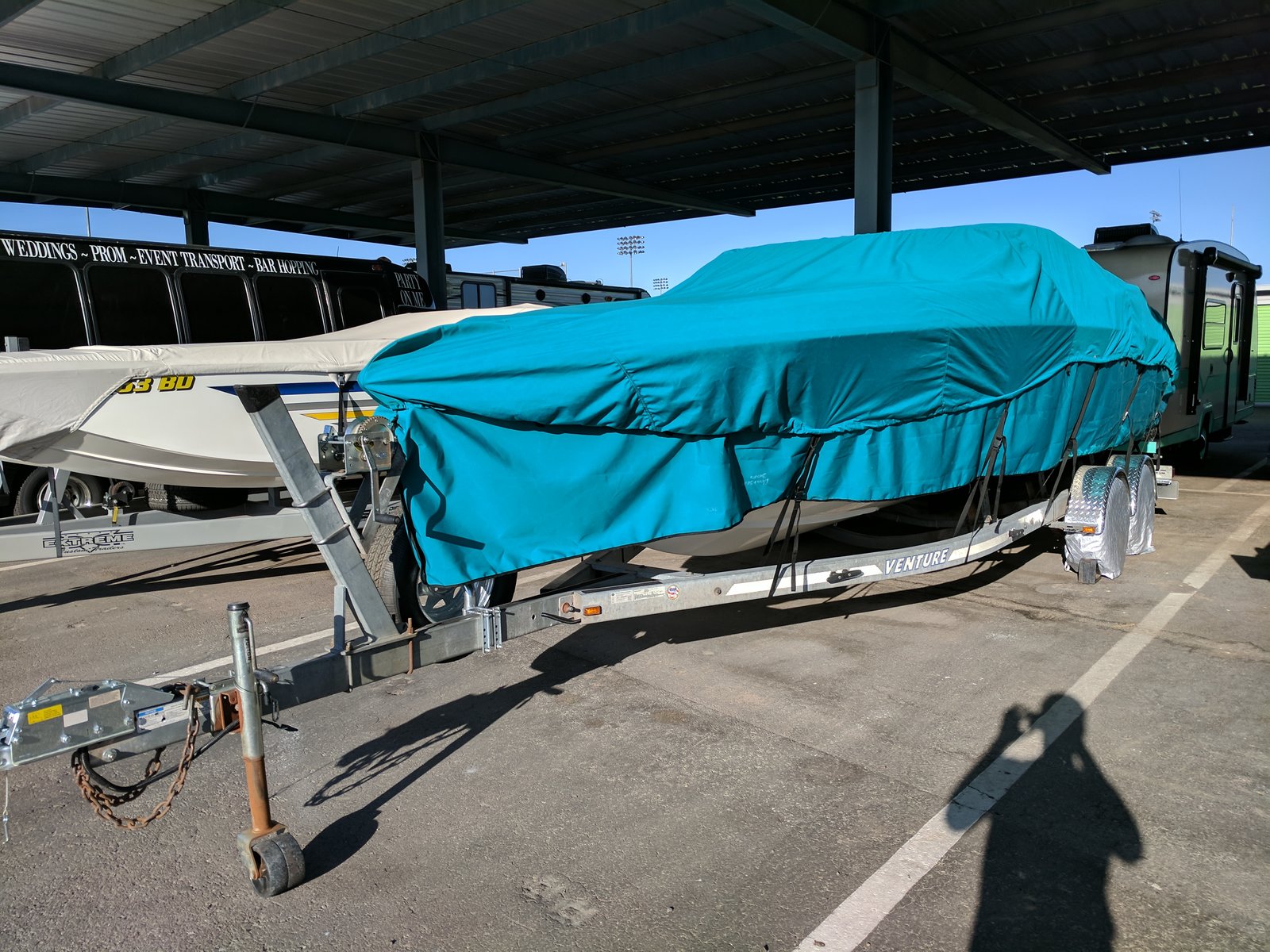

    Finally got side skirts on. Sun ain't gonna get her again :)

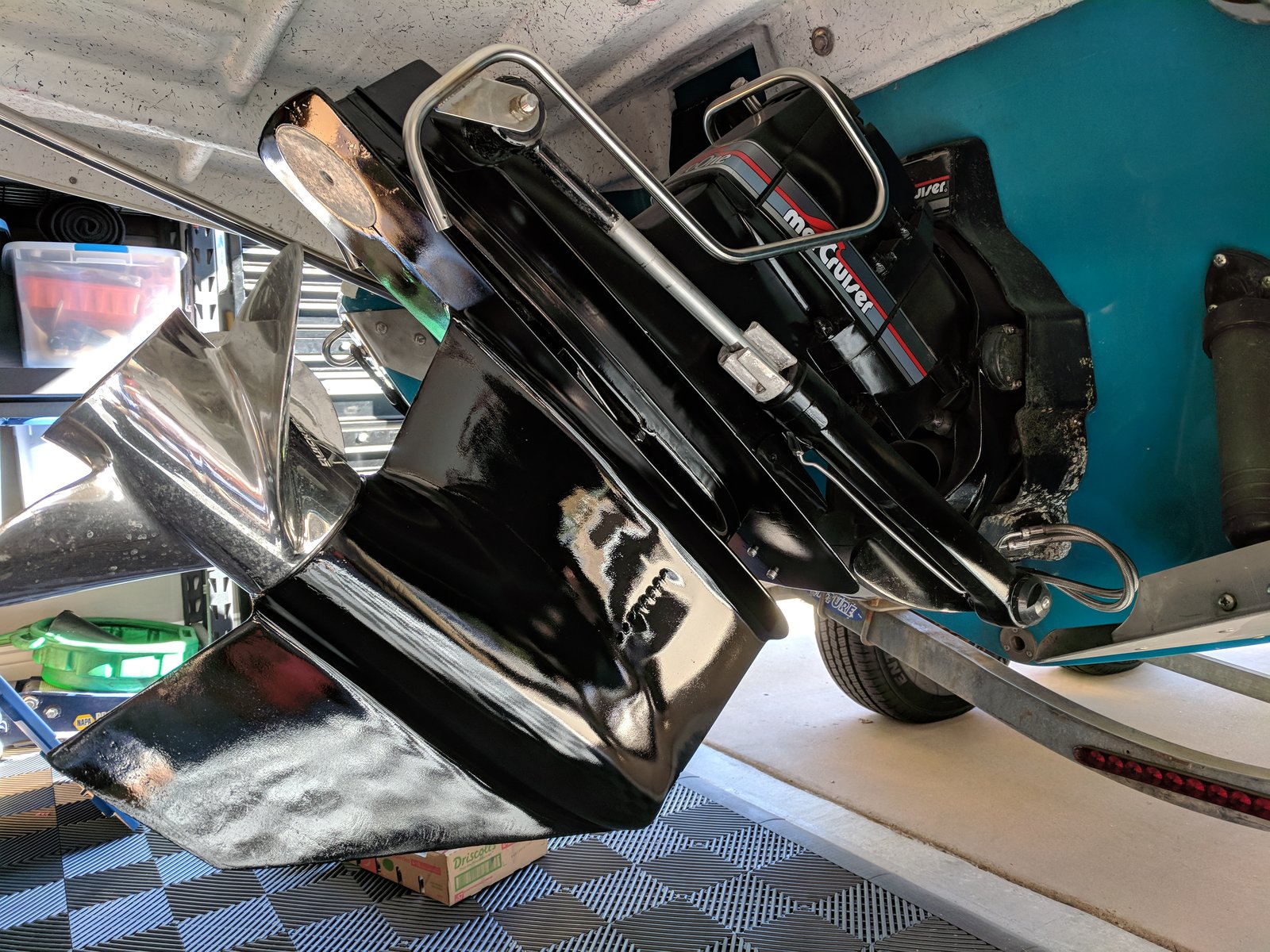

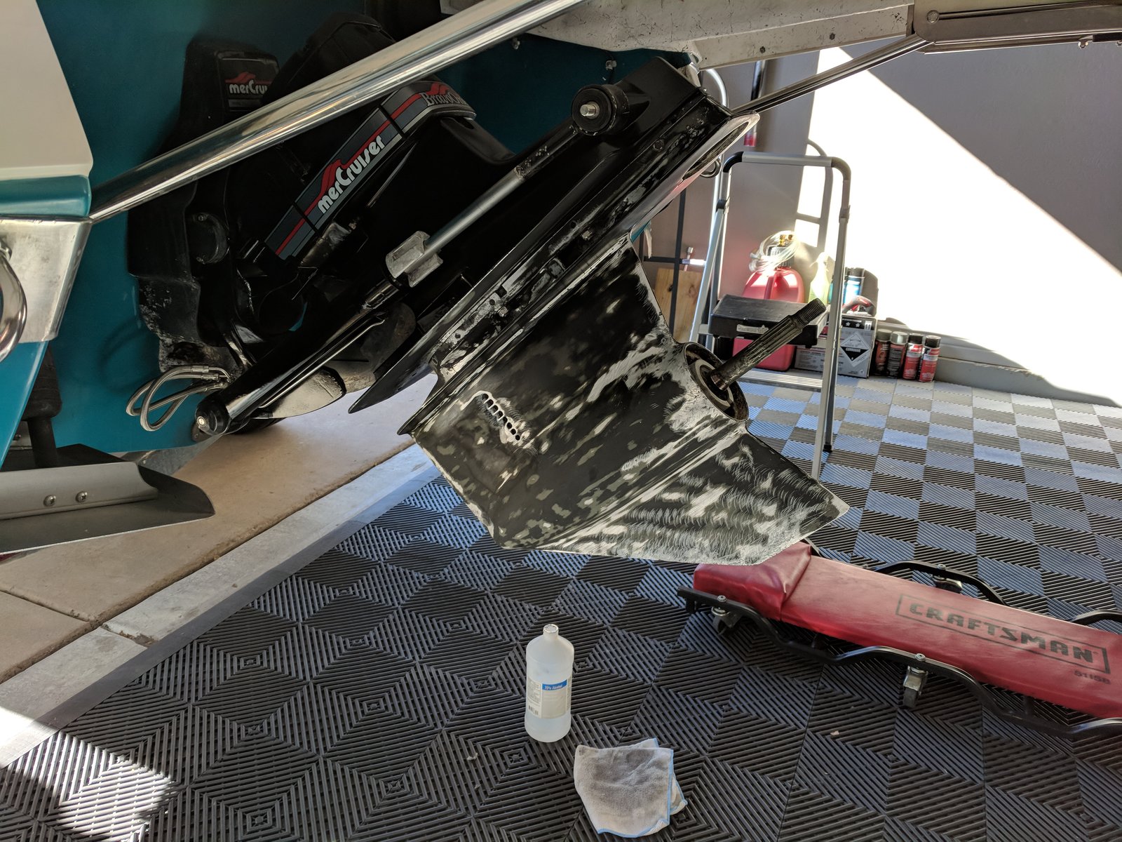

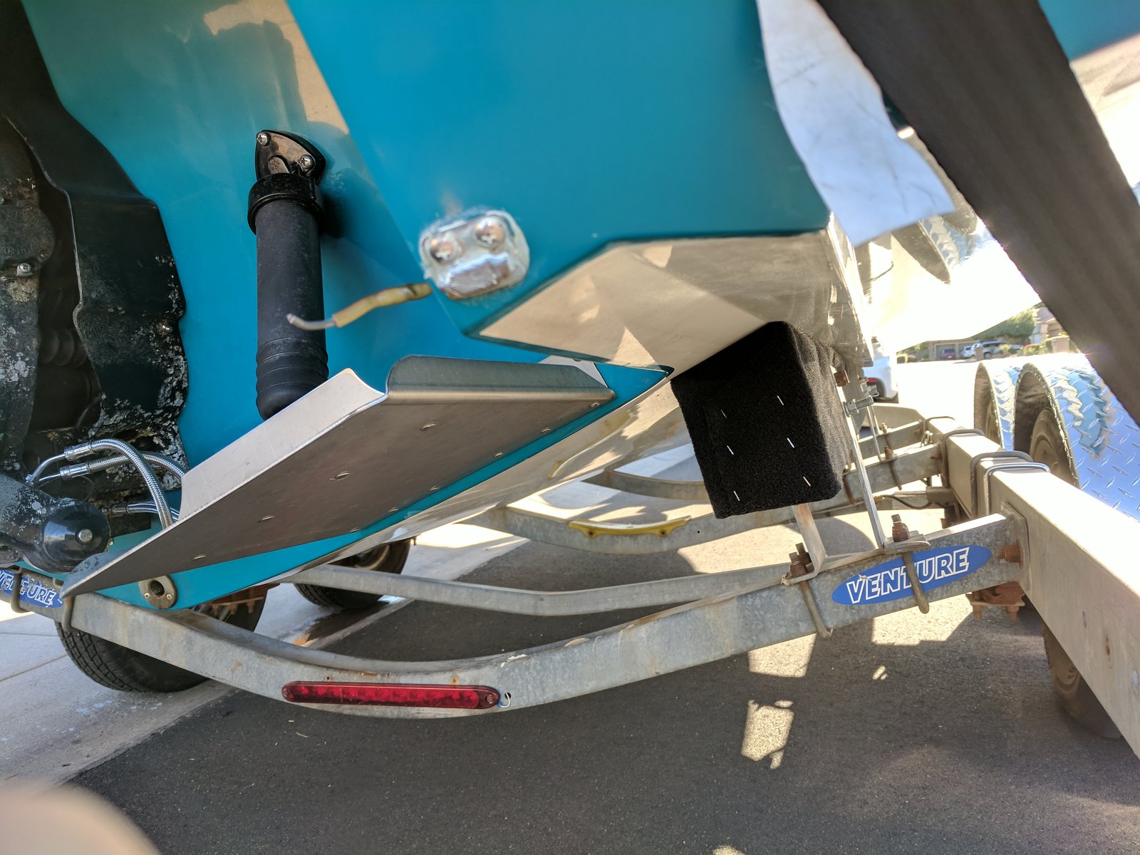

    Also finally got the anodes replaced. The old ones were magnesium, I replaced with aluminum since there's a possibility of the occasional salt water trip. Most of the old ones were probably marginal, but the one under the prop looked like it had been skipped last time. It fell apart on me before I got the bolts out. Whoever did the prop last time didn't bend the tabs on the nut keeper back down...eeek!

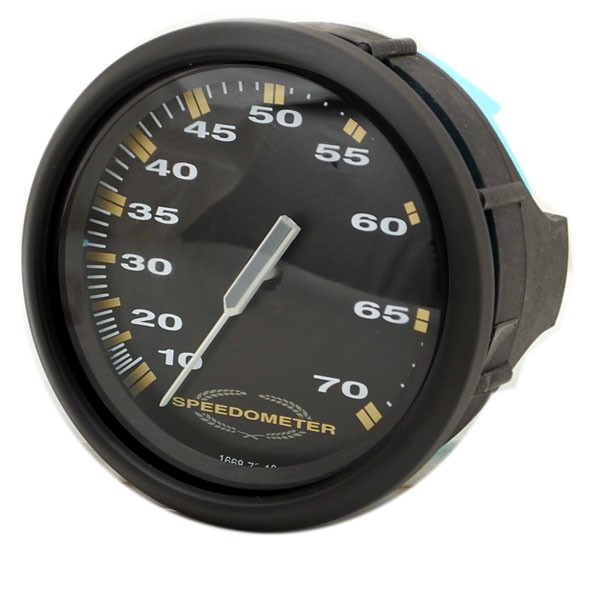

    Got another round of parts on order too:

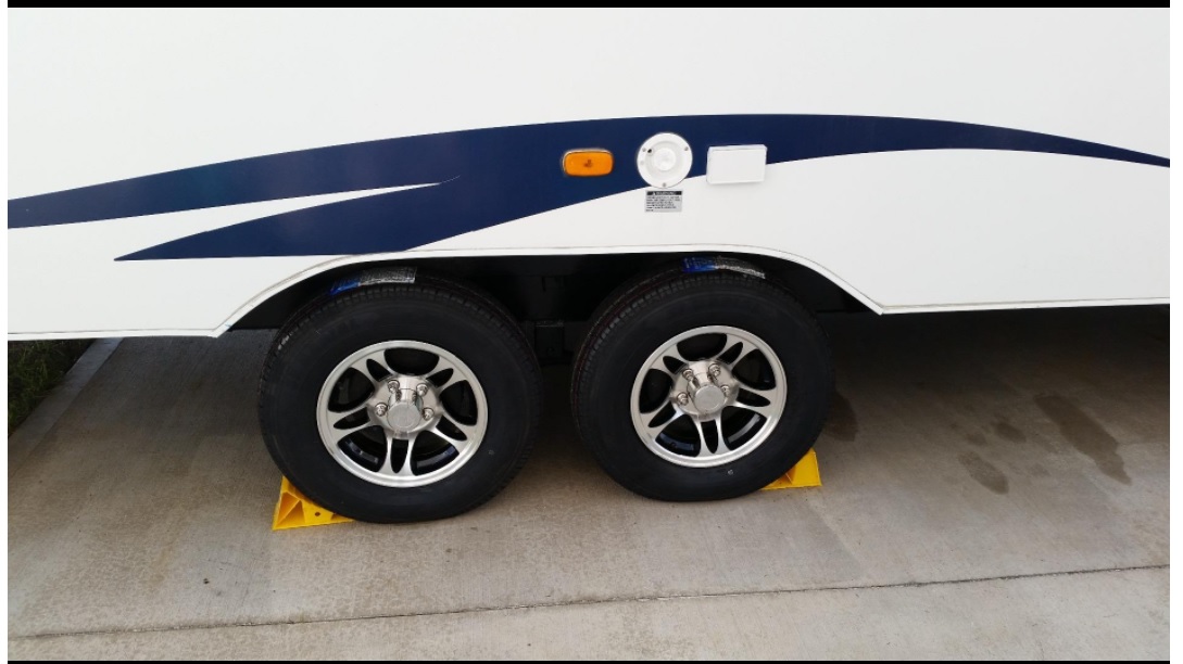

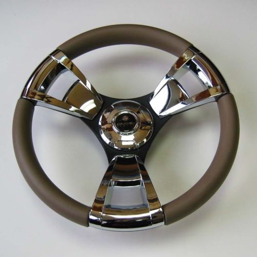

    New wheels (stole this pic from an Amazon review)

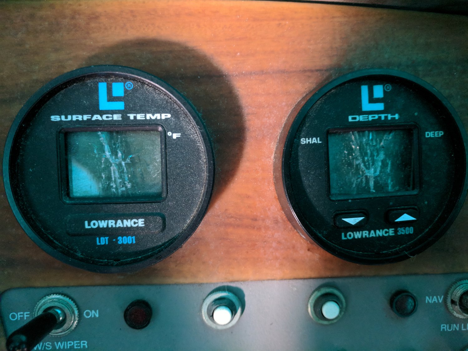

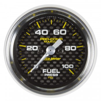

    Ordered a Lowrance LST-3800 depth/temp gauge. My current temp gauge doesn't work and the depth gauge has bad LCD segments (is that 7 feet deep or 1, who cares right??), on top of the cracked screen overlay. The LST-3800 comes with a transom mount transducer. I would really prefer not to drill extra holes below the water line, so I called Lowrance today and we found a shoot-through transducer with an external temp probe that will work with the gauge. P/N PDRT-WSU in case anyone is interested. The transducer will go inside the hull under the engine, and the temp probe will mount outside like the original one did.
    Since the temp and depth functions will be combined into a single gauge I have an extra hole to fill...ordered an Autometer marine fuel pressure gauge for that slot. If I squint just right and ignore the chrome bezel I can almost convince myself that it almost matches the factory gauges :)

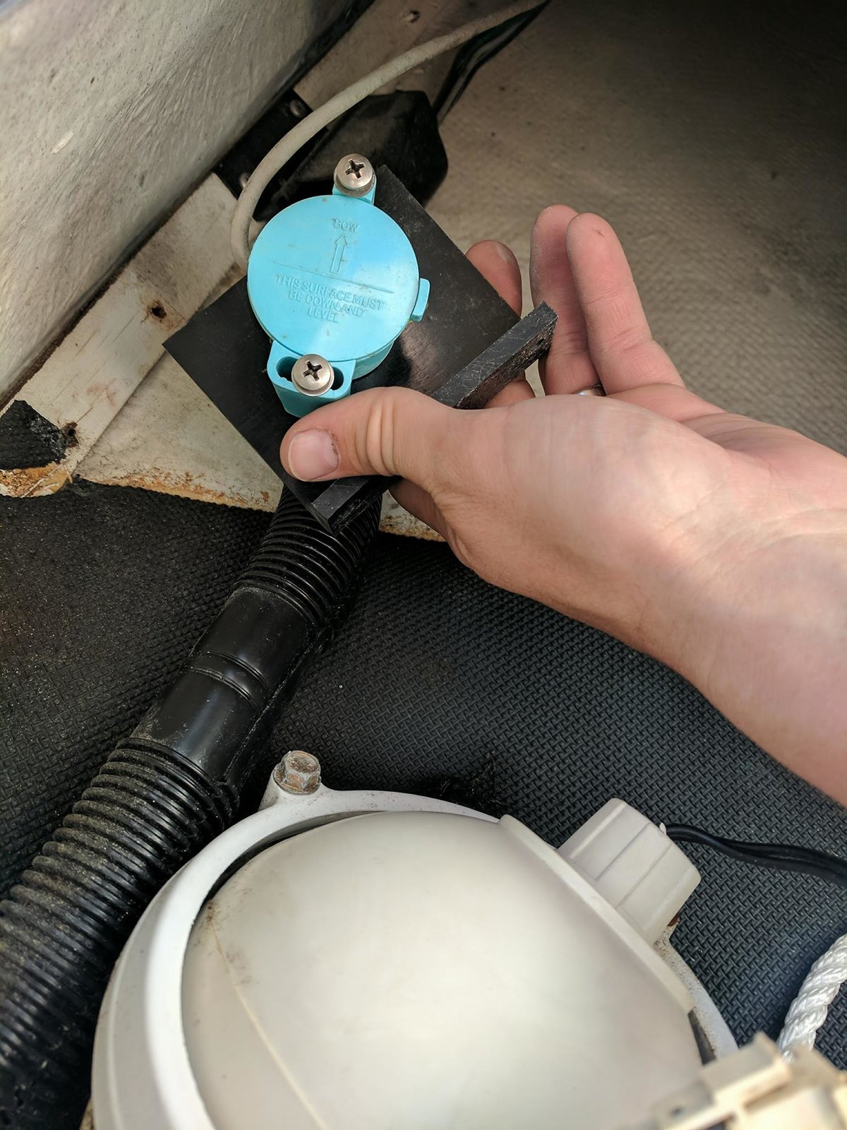

    Also found that my alarm buzzer/beeper thingy (the 1-2 second beeeeeeep when you first turn the key) is not working. Found a set of 2 replacements on eBay for $18 shipped, so that will be fixed here this week too.

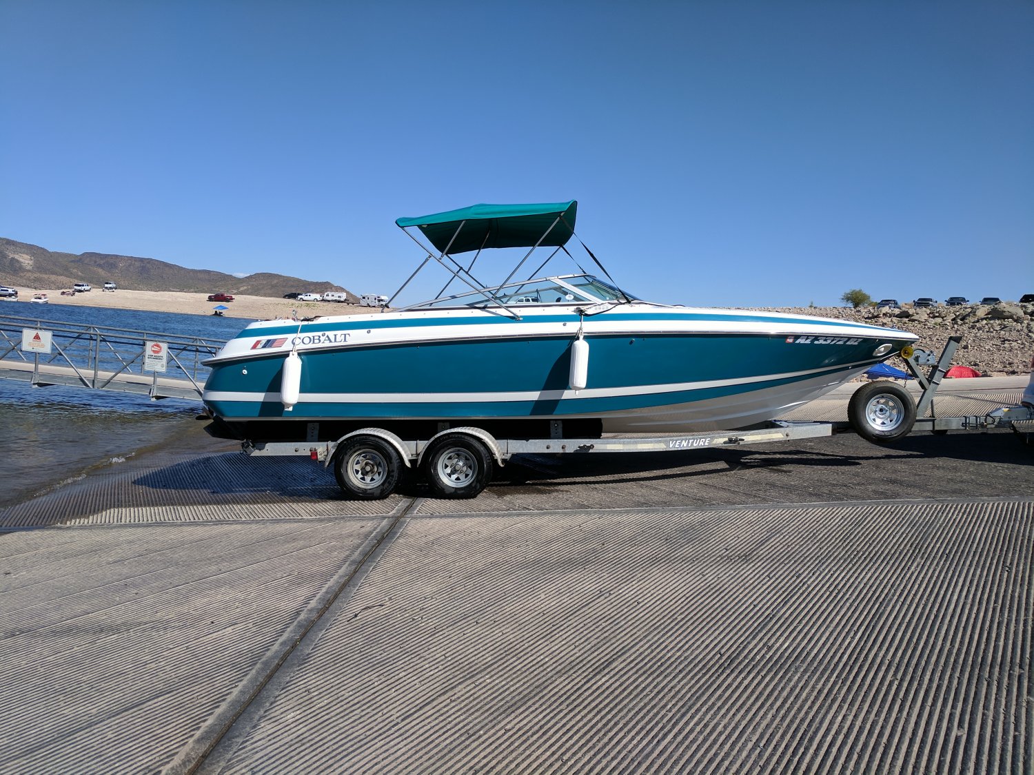

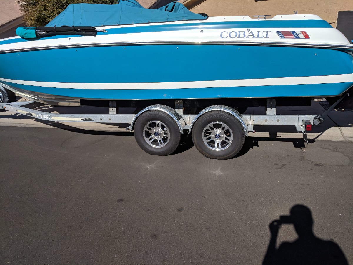

    New wheels and tires on the trailer. Looks better and pulls better. Went from a 215/75-14 to a 235/75-15, supposed to be 2.2 inches larger but measures out to about 3" larger diameter. Keeping an eye on inner fenders for rubbing, seems ok after our trip today but may need to move fenders up a bit. Went from 3" clearance to about 1.5". Looks closer in the pics due to the fender lip, but that falls outside the edge of the tread.
  21. Muggsy
    Looks very nice. Can't wait to see the new platform. I know you are going to love it. Post lots of pics. If you are there during the install try and take pictures of the actual installation and post them in a separate new thread. Some might find it interesting.

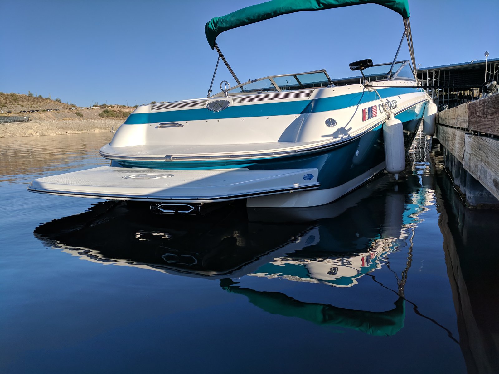

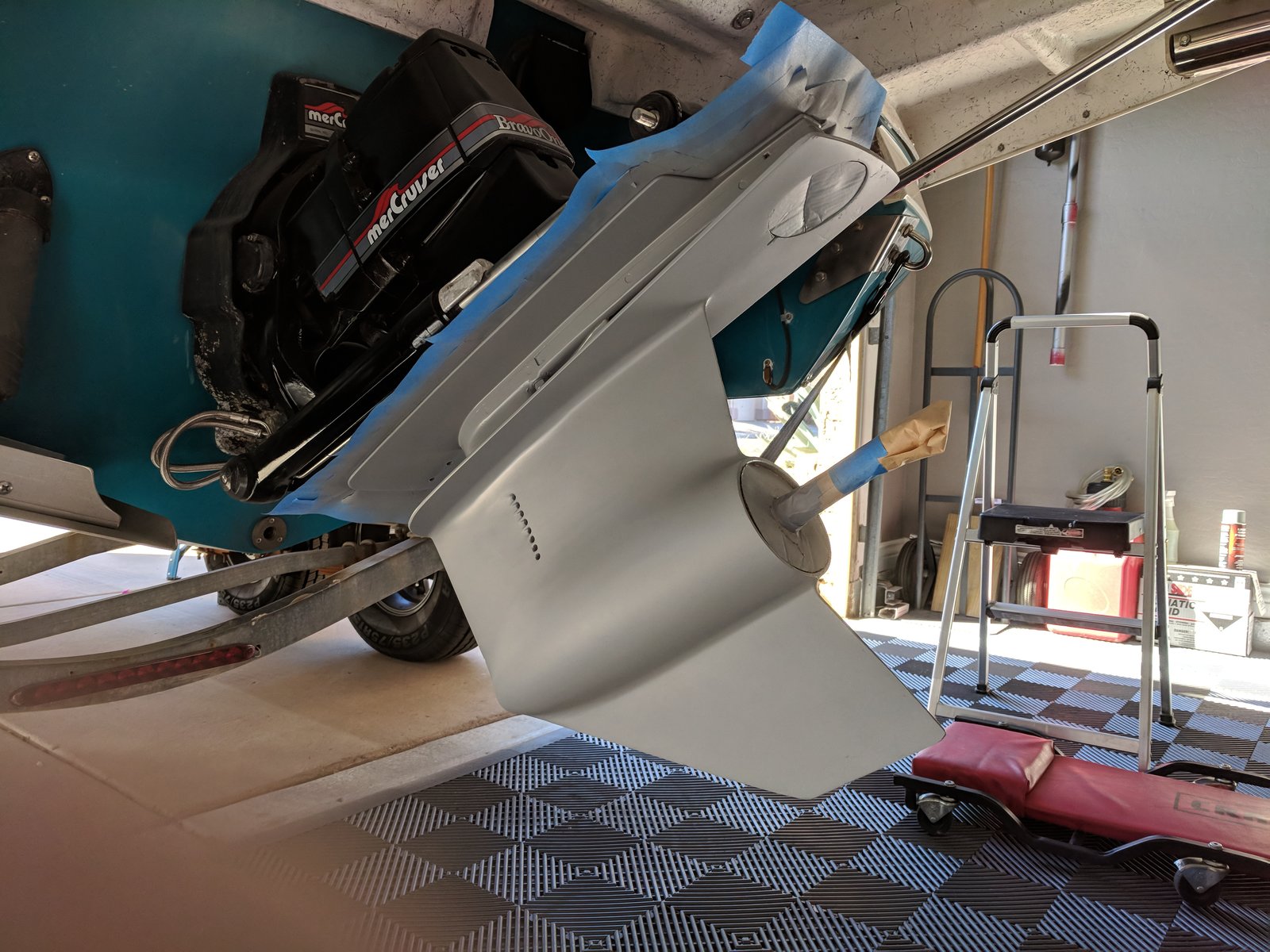

    I can't remember which threads I've updated, but it's been a busy couple of months. Got the swim platform done, repainted the drive, added some reproduction Bravo decals, added a Simrek drive shower, bought a polisher and had another go at buffing out the hull, got my new depth finder in, added a cheap GPS speedo to fill the extra dash hole, replaced inner seals and repacked bearings on the trailer, got the engine and drive oil changed. Probably forgetting a couple things but wanted to post some more pics. IMG_20171029_163005.jpg IMG_20171118_095927.jpg IMG_20171118_105041.jpg IMG_20171118_133411.jpg IMG_20171119_143758.jpg IMG_20171119_143813.jpg IMG_20171119_143837.jpg IMG_20171118_113120.jpg IMG_20171118_130051.jpg
  23. Muggsy
    Looking very nice....
    thunder550 likes this.
  24. Walt P
    Looks great! Nice work.

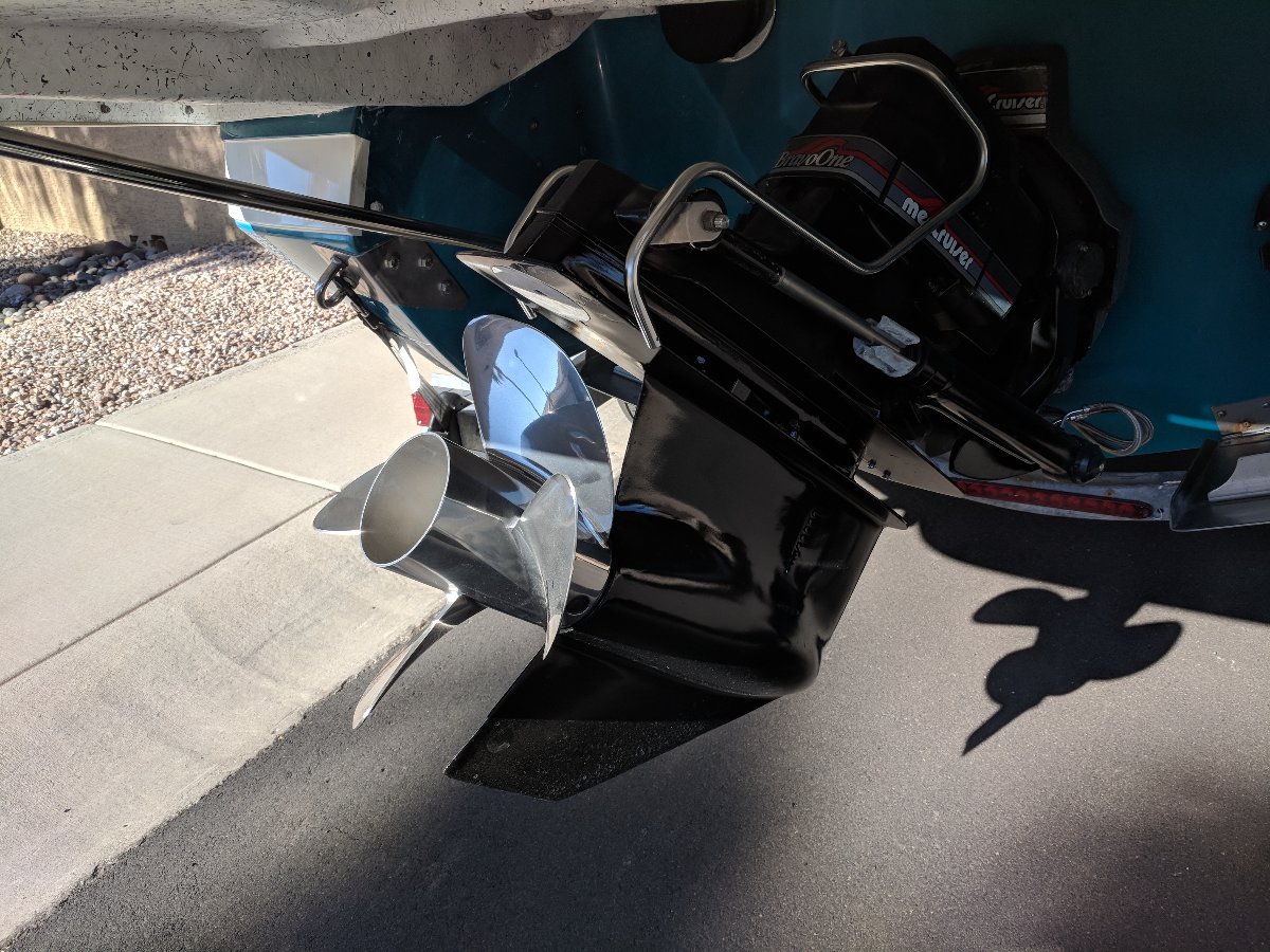

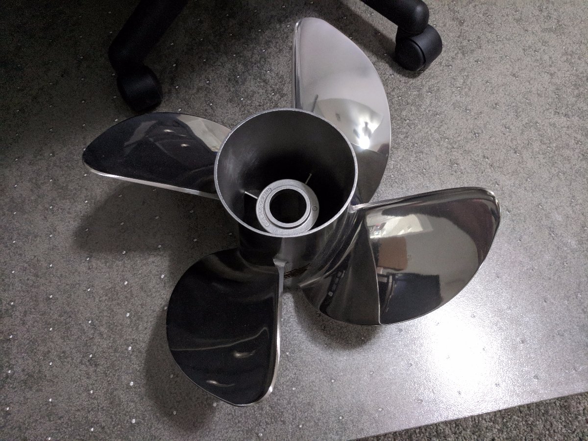

    Few more updates....got myself a new prop for Christmas, Revolution 4 21" pitch.

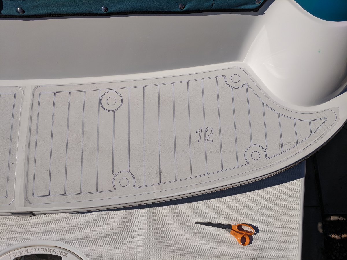

    Ordered Seadek for the factory swim platform, factory non-skid is worn down and we've had a handful of slips. Haven't received the pads yet but the dry-fit templates from a '99 model year 252 match my '95 except for the location of the ladder holes. I had the ladder holes deleted completely since my ladder is gone.

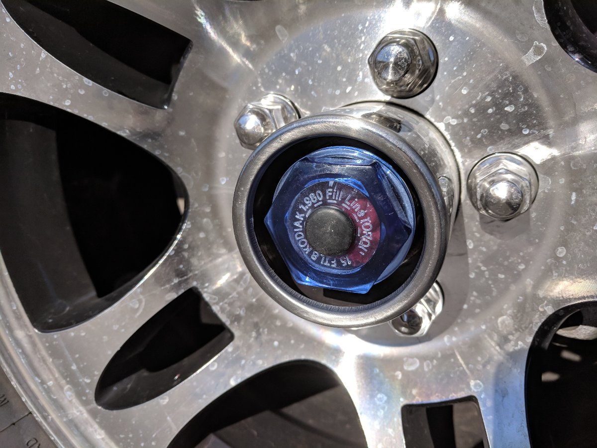

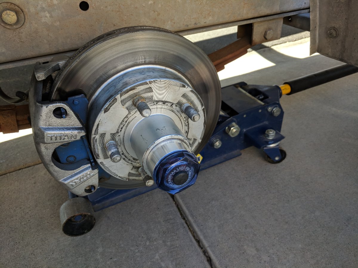

    Also got some new bearing caps, the ones I bought from Amazon kept leaking water. These ones are designed for oil bath hubs but work well for grease too. Since the caps are transparent I can keep an eye on grease condition without taking anything apart.

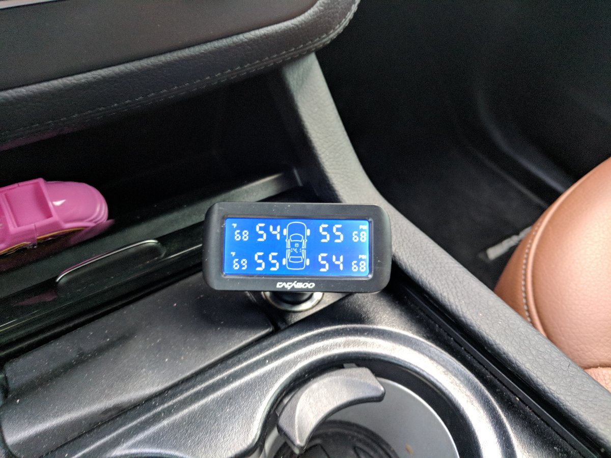

    Got a TPMS system for the trailer tires

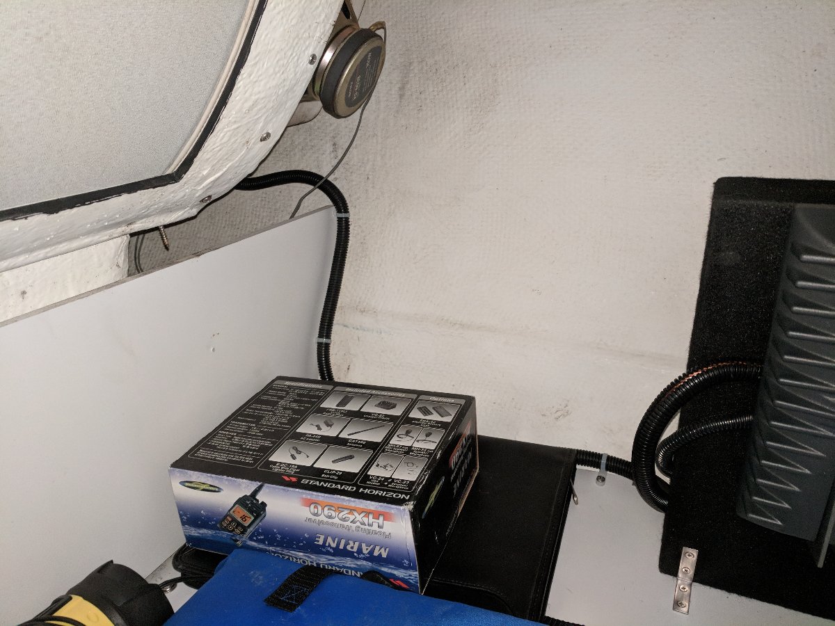

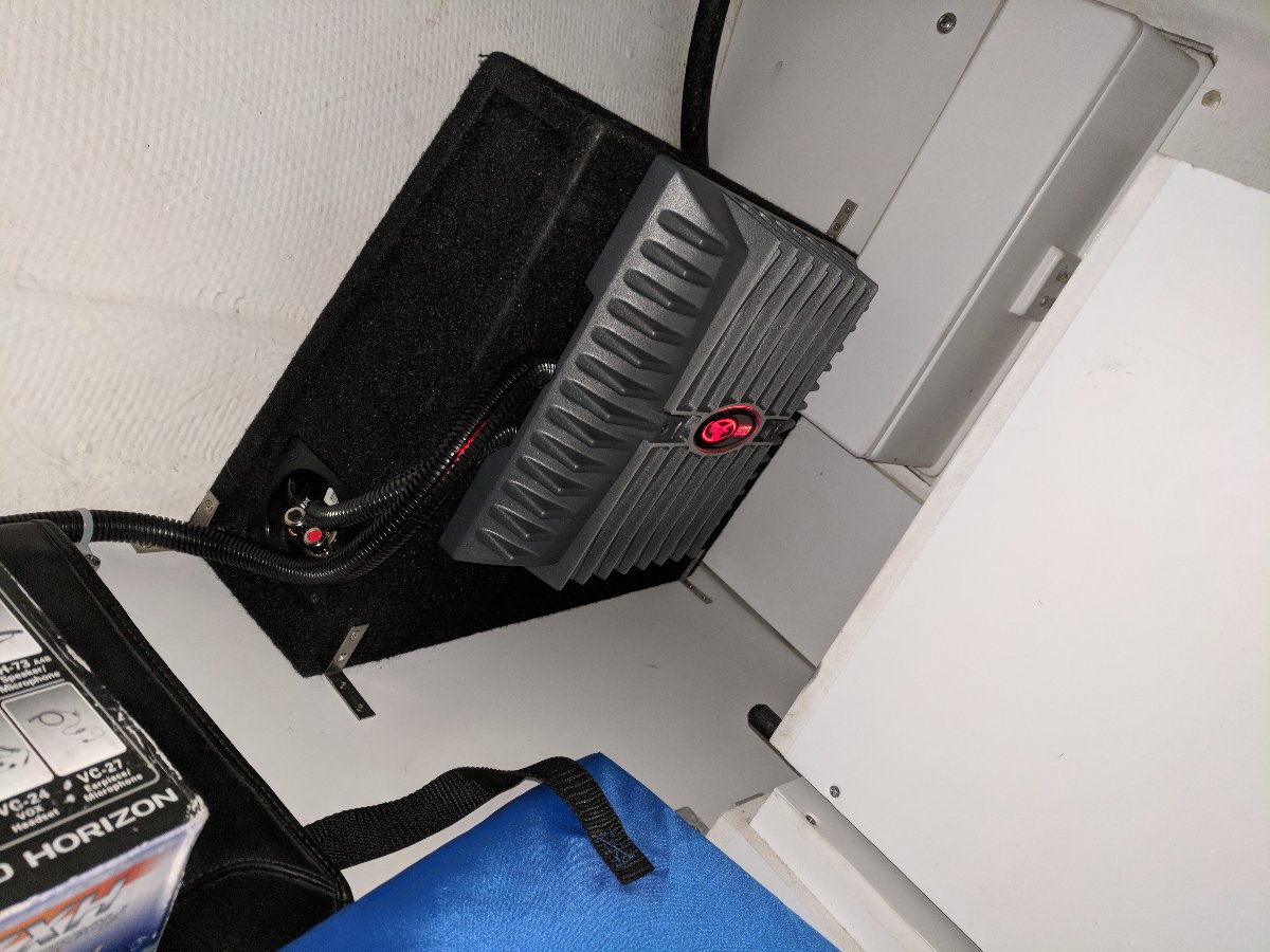

    Added a small amp and 10" subwoofer

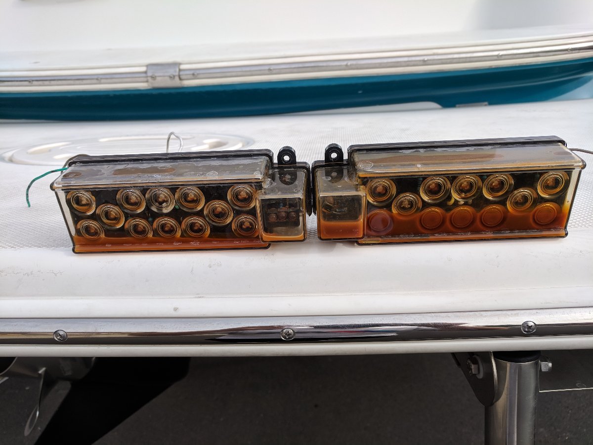

    The Amazon LED tail lights I put on the trailer were starting to go out, took them apart and they are definitely NOT waterproof as advertised. The seller sent me a set of replacements for free, which was great. I sealed up the plastic joint with 5200, hopefully these ones will last longer than 3 months. If not, I'll have to bite the bullet and order a nicer set from a reputable source instead.

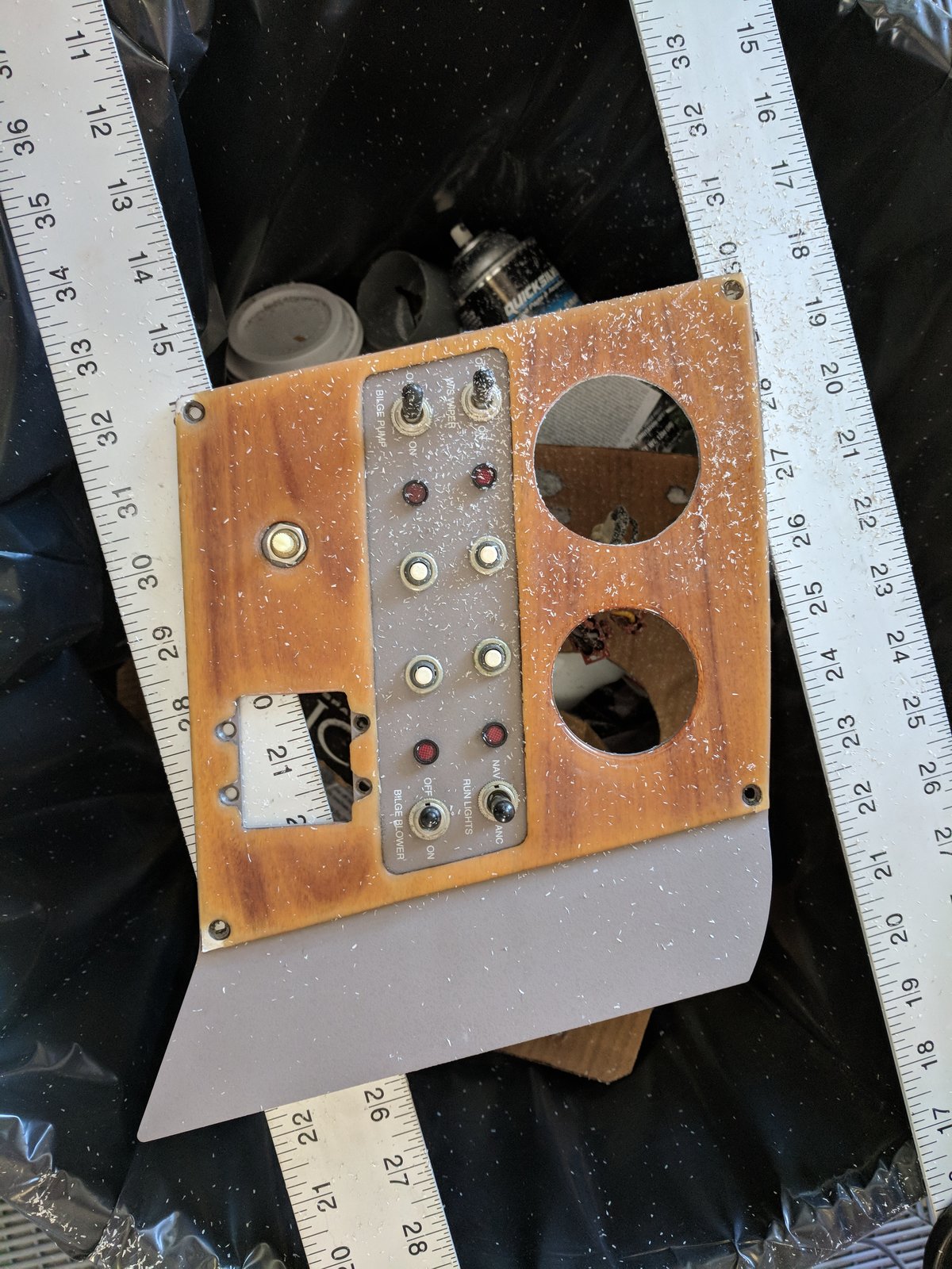

    Decided to try and vinyl wrap my faded dash panels. Got one done this past weekend. It's far from perfect but looks a lot better than the original faded panels. I'll be interested to see how it holds up in the heat. Spent a grand total of $45 on material for the whole dash and $23 on a heat gun, I figure for a total investment of $70 and a couple hours of labor it's hard to go wrong, even if it doesn't hold up long term. Also, since I have to take the steering wheel off to do that panel, I decided to steal Rob's idea and replace my steering wheel with the exact same one he used. His turned out great. Have not received it yet, but hopefully it will match the vinyl color on the dash pretty well.

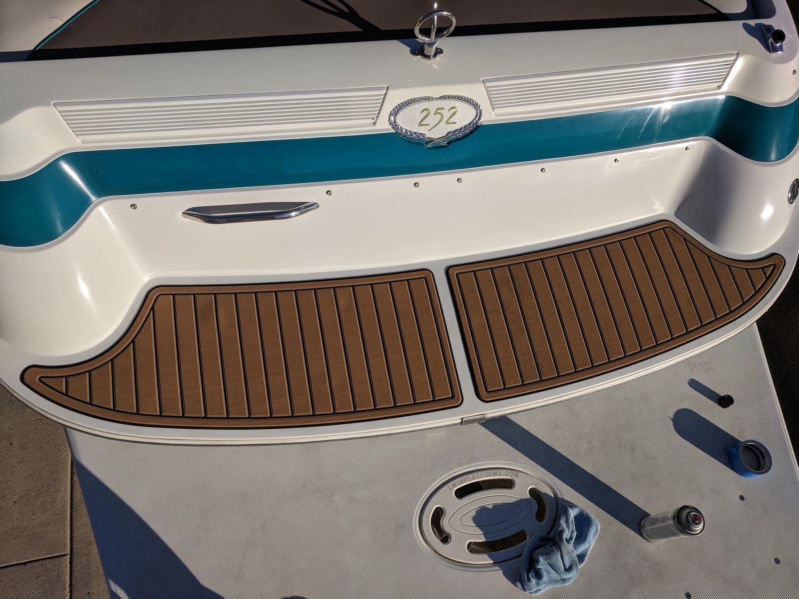

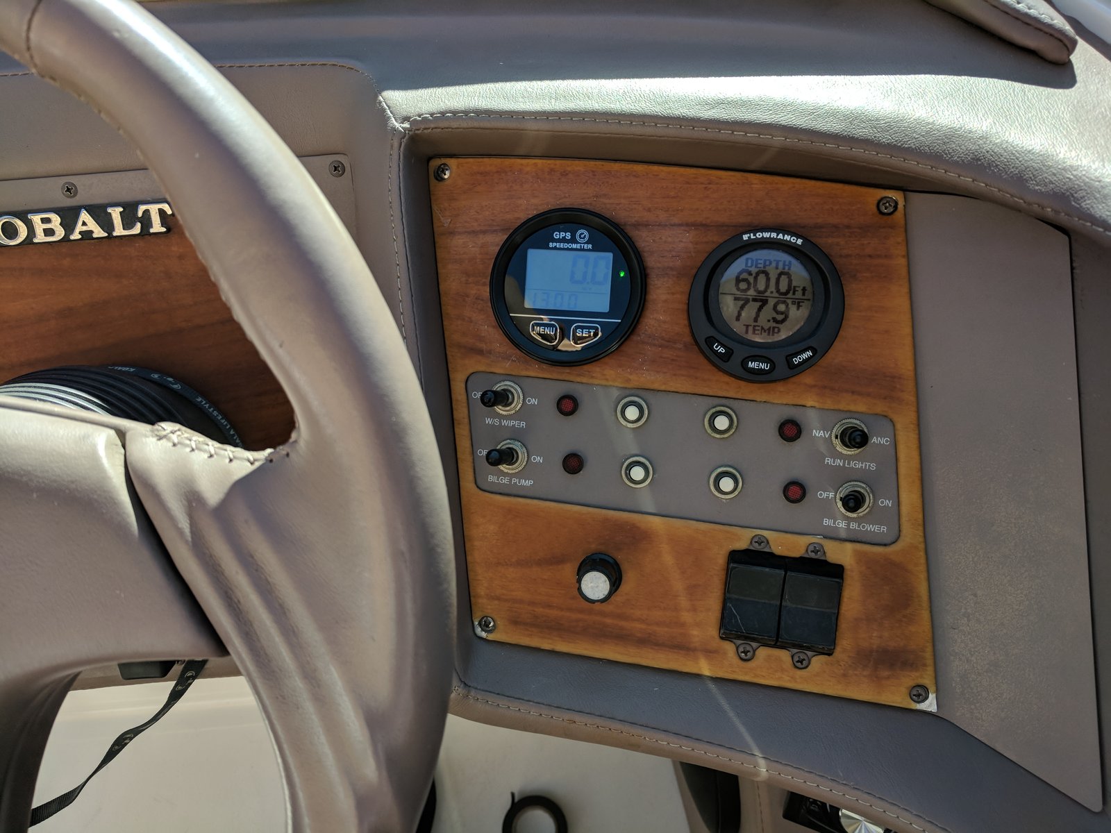

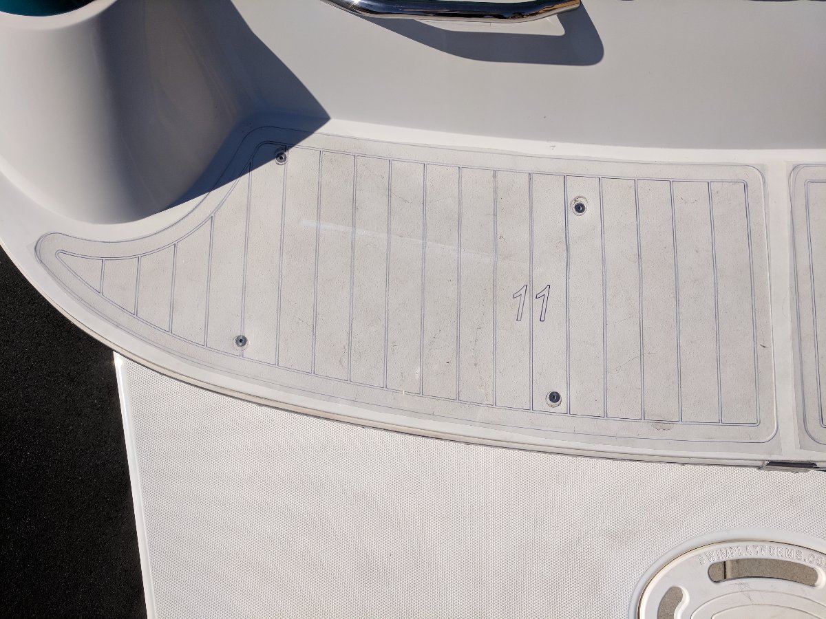

    Got the dash panels finished and SeaDek on the swim platform
  30. Walt P
    Looks good. Nicely done!
