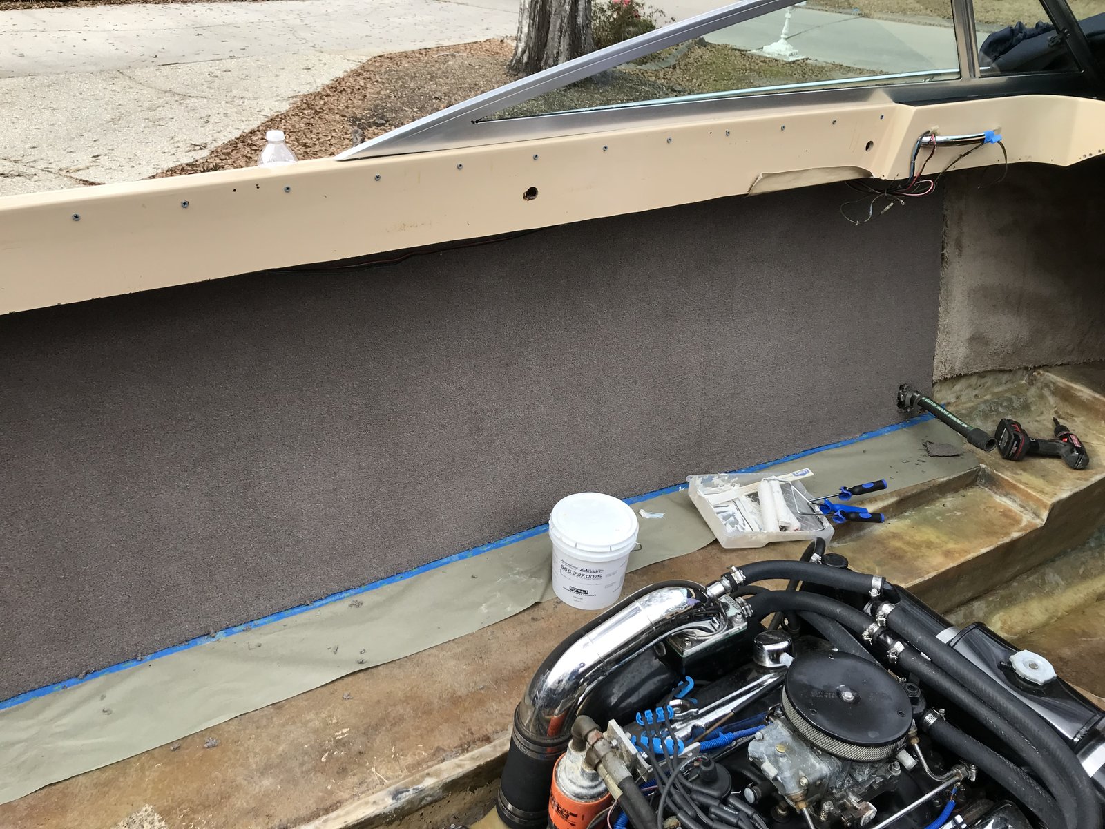

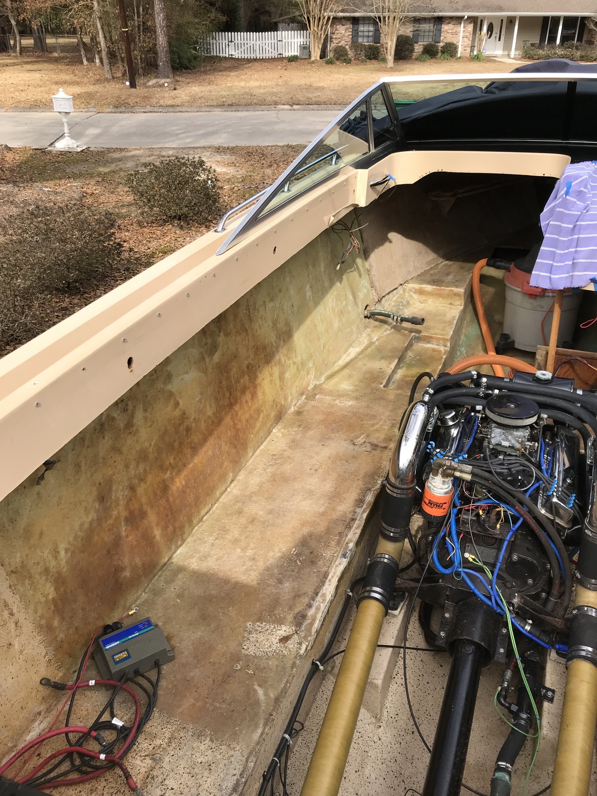

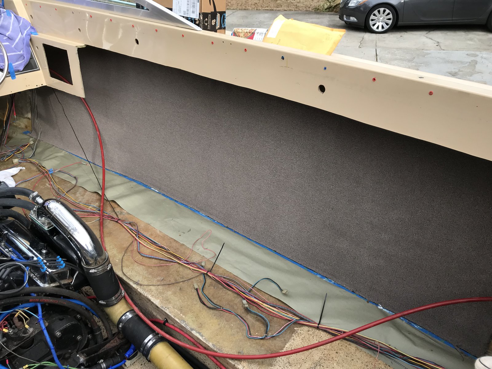

    After my friend went back to Cal we were at a place where the motor fires up, gauges all work and there is power to the new switch panels. We tested the outputs but did not wire anything permanently. I needed to get the new carpet on the inside hull-sides so I could tuck the wire harness up under the gunnels. Before I could do that I needed to get the very old adhesive off first and we all know how much fun that is. So armed with my angle grinder and a wire cup brush I suited up and attacked. As expected it was really messy but it actually came off pretty easily. Here is both sides ready to put on the new....
    The biggest problem with installing the new carpet was the temps. The adhesive is supposed to be in an environment over 60 degrees and it has been so cold here in the south I couldn't get it done. But late last week it finally started warming up enough to get after it. Below is after installation....

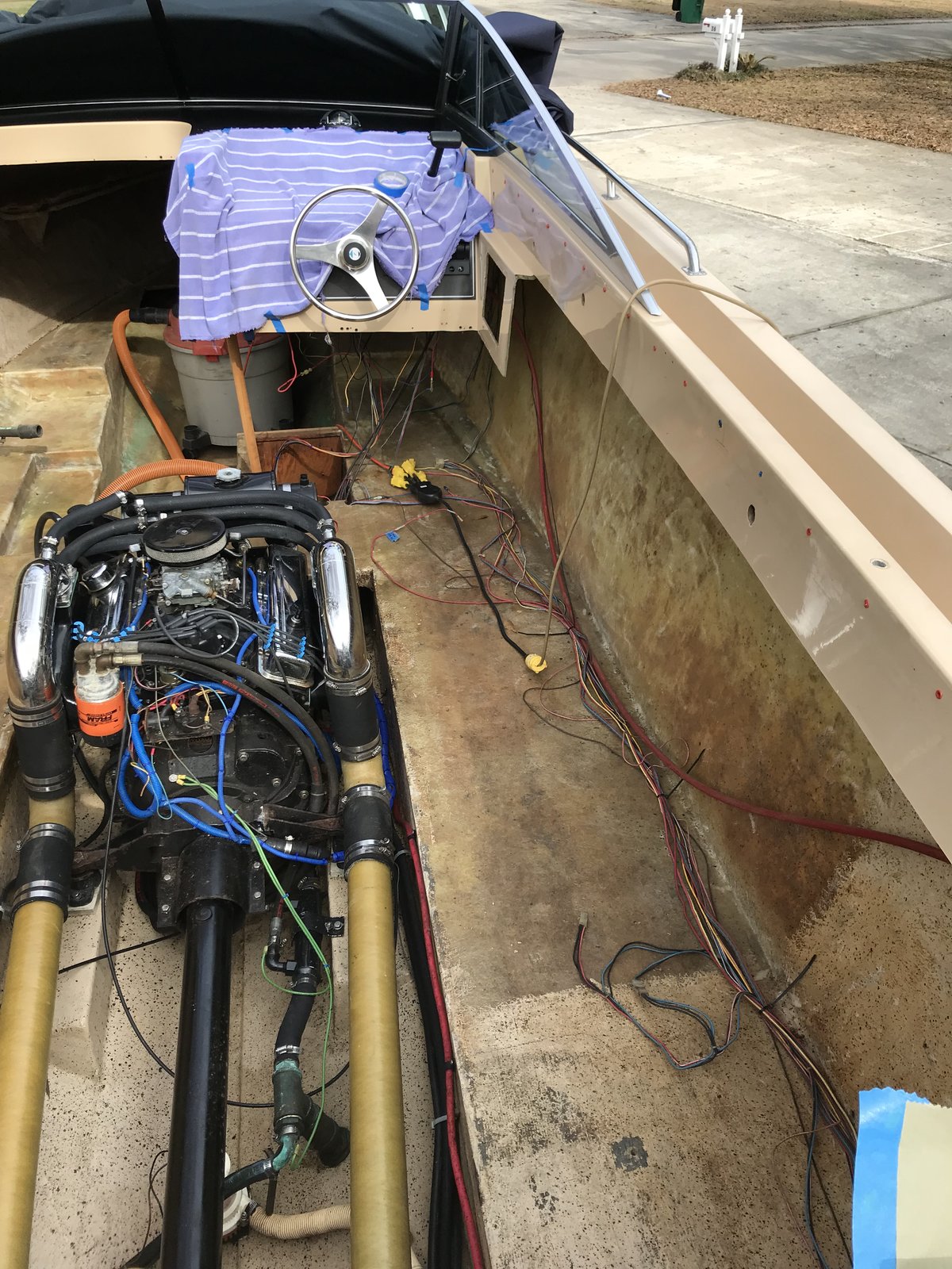

    As of a couple of days ago I got the steering cable and all of the wiring up under the gunnel. I have been going back through the wiring and cutting out, and replacing, 32 year-old corroded connectors. From the new switch panels the blowers, bilge pumps, horn, GPS and courtesy lights are all functional.

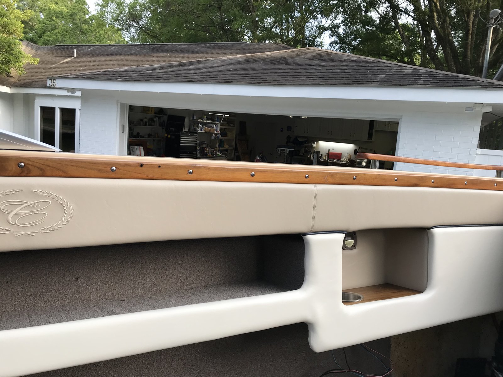

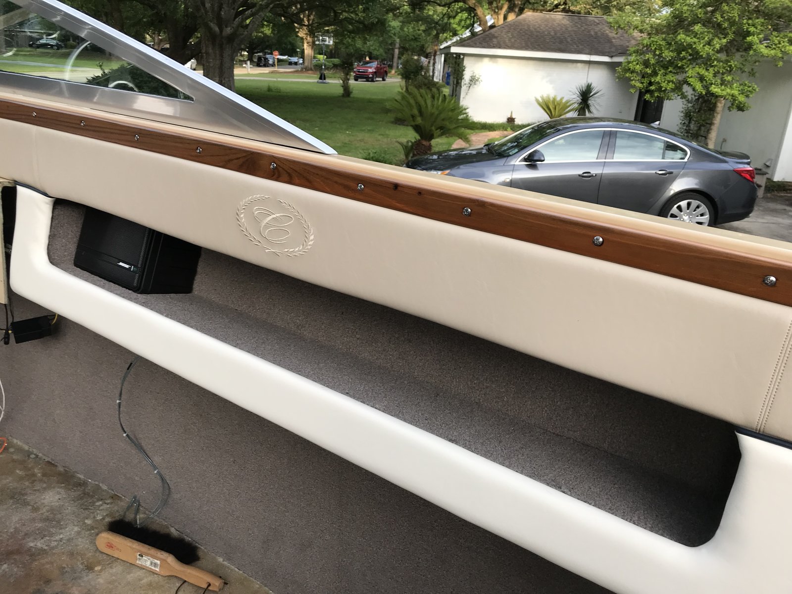

    I have been plugging a way at the Cobalt this spring. After I got the carpet on the hull inside I had the upholstery finished on the side panels then I installed them so I could finish the wiring and courtesy lighting. I'm pretty happy with the logo embroidery. I think it classes things up a bit.

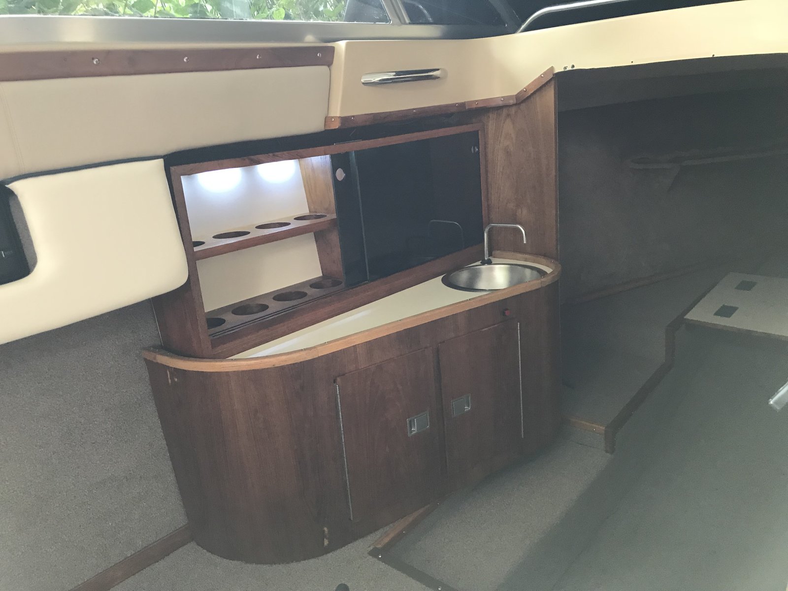

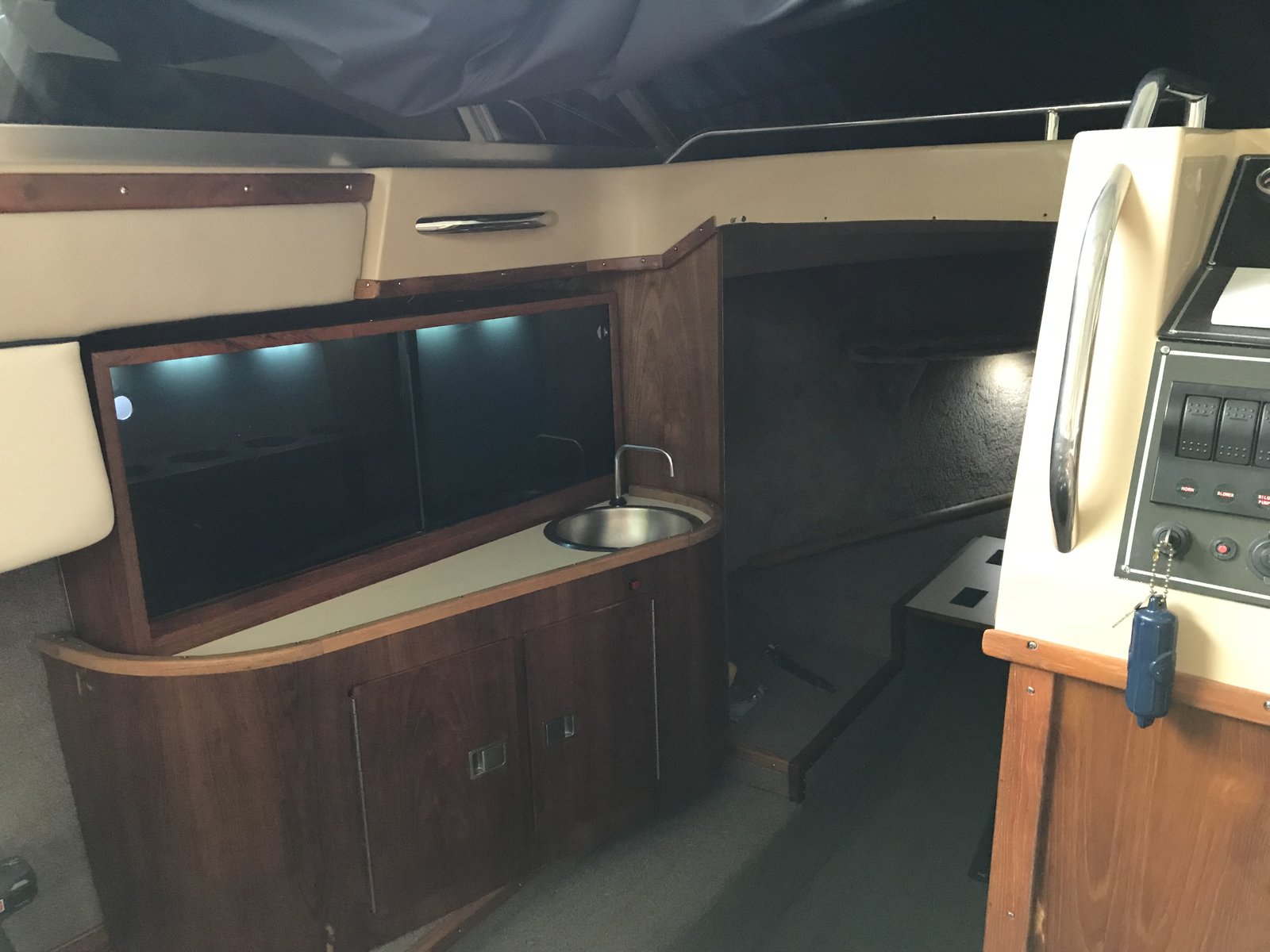

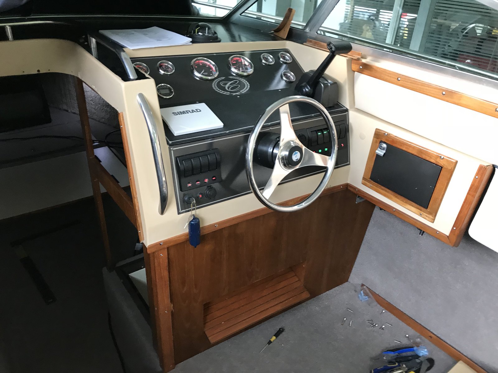

    This week I reinstalled the wet bar and started putting the helm cabinet back in....

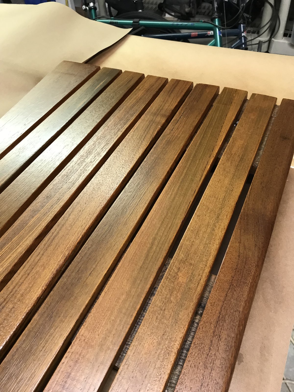

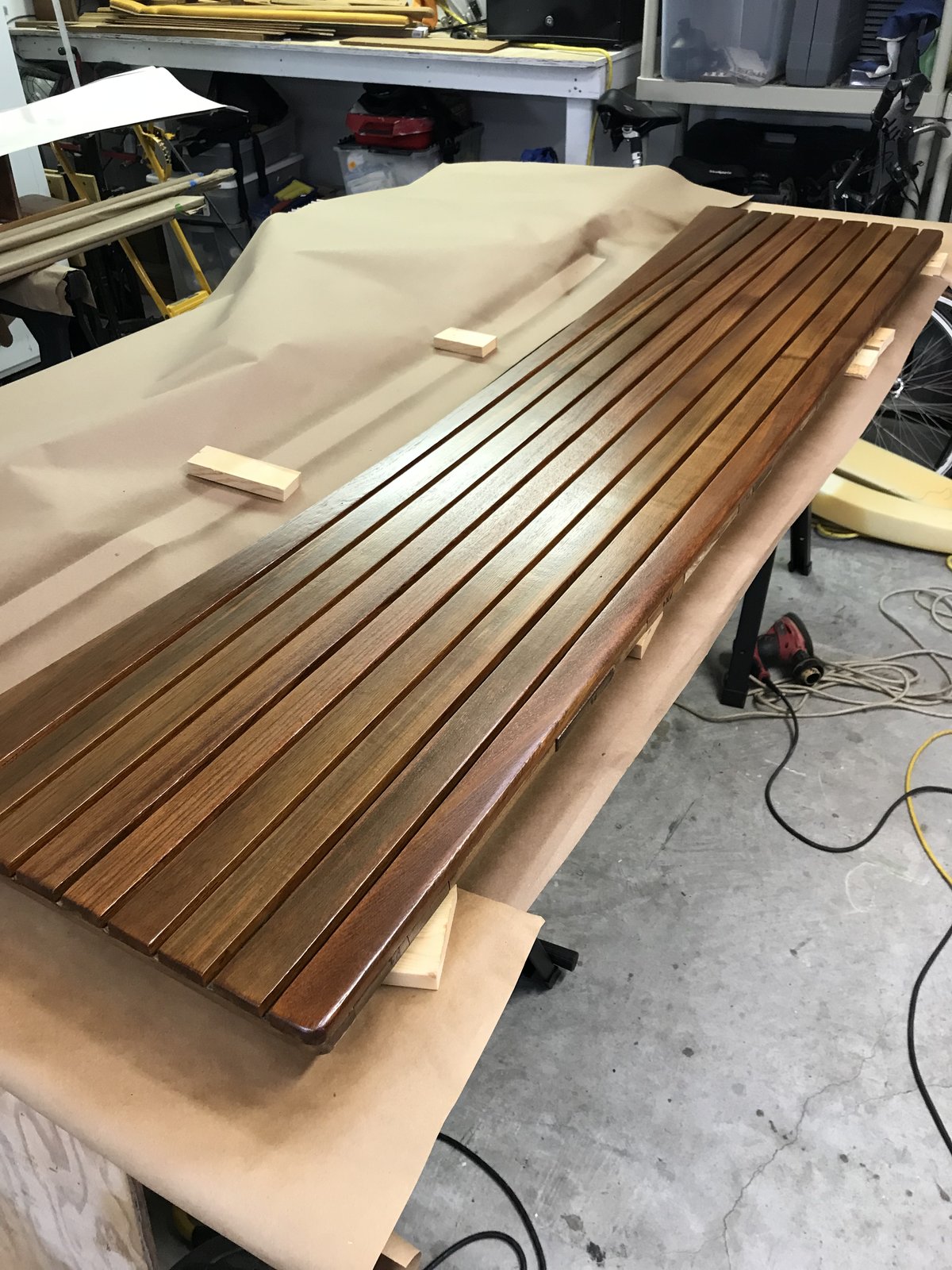

    IMG_0810.JPG IMG_0813.JPG IMG_0811.JPG A month or so ago I also rebuilt and refinished the teak swim platform. This was in pretty rough shape but I think it came out pretty good....

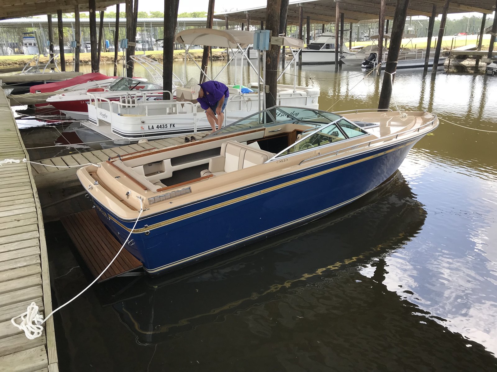

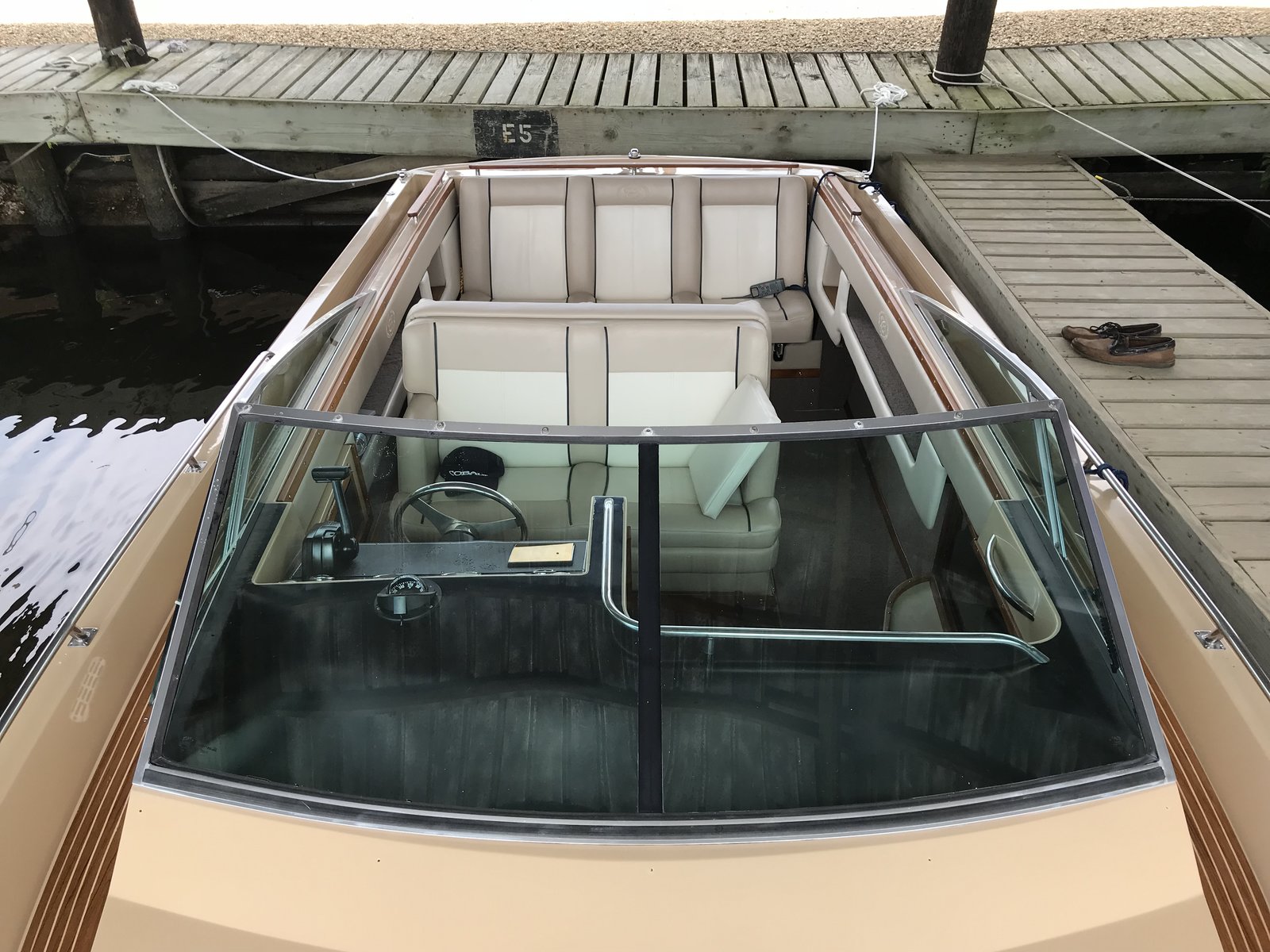

    Well the launch went OK, the trailer needs some attention. Knew that was coming though.... The motor ran great. Good oil pressure and temp. Fuel gauge still not working and the depth gauge is doing weird stuff....all minor items I think. The biggest problem is the Merc power steering system has a problem. The boat wants to turn to port....hard if I let go of the wheel and she lists to port while on plane so the power steering is not compensating for prop torque I think. And while cruising at idle and I turn the wheel I feel a jerky feedback in the wheel and the whole boat. The pump reservoir was at the proper level. I need to do some research.
    Here is a pic in the slip she'll be in for a few days while I work on the trailer.
