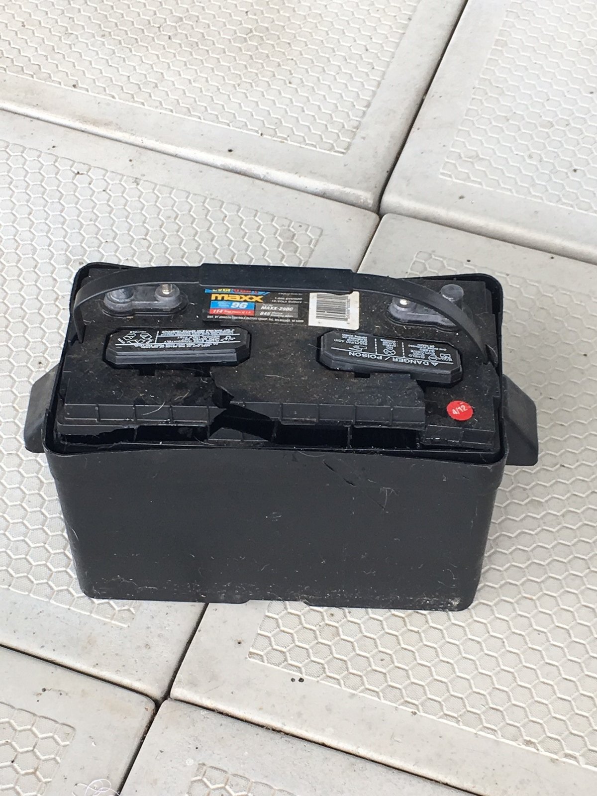

Your radio may be using one battery to stay programmed, even though you have the battery selector shut off. I had that issue until I realized the radio was draining the battery in between outings. One 3 week stretch drained battery #1, and #2 was fine. After we were running and selector was at "ALL" #1 charged back up. Also, a safety tip- if your battery has the ability to be topped off with distilled water or electrolyte, check regularly. I have another boat (Carver 3307) and had not checked fluid levels since I bought the boat. Went to crank the Port engine, and BOOOM! The battery had dried up due to in line charger, and the demand for power caused an explosion. So kids- check those levels.
Yikes! I had the same thing happen on my 2008 Sea Ray. I smelled a bad sulfur smell one day and looked in the engine room and found battery acid all over. It was a nightmare to clean up because the battery wasn't in a battery box to contain the mess. I poured baking soda everywhere to neutralize the acid then wiped everything down. It took all day. I agree with Walt...check you batteries often!
