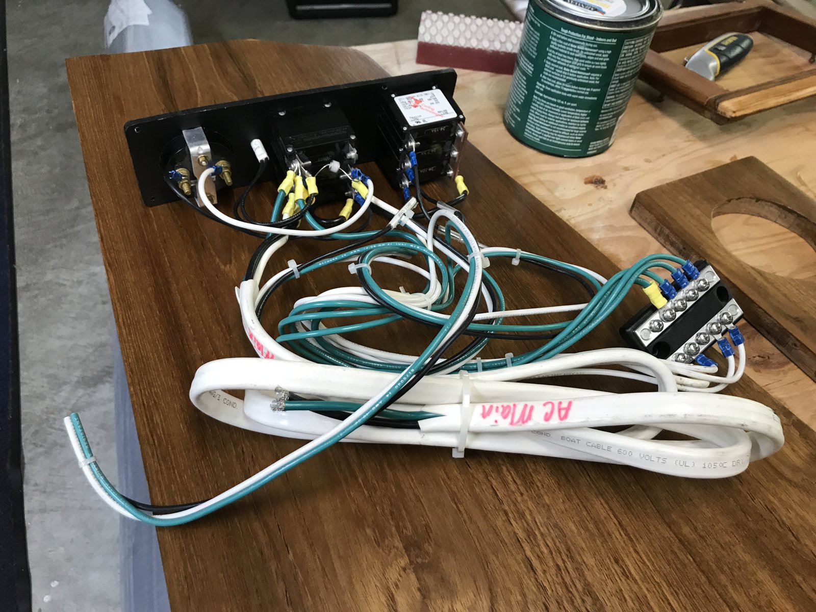

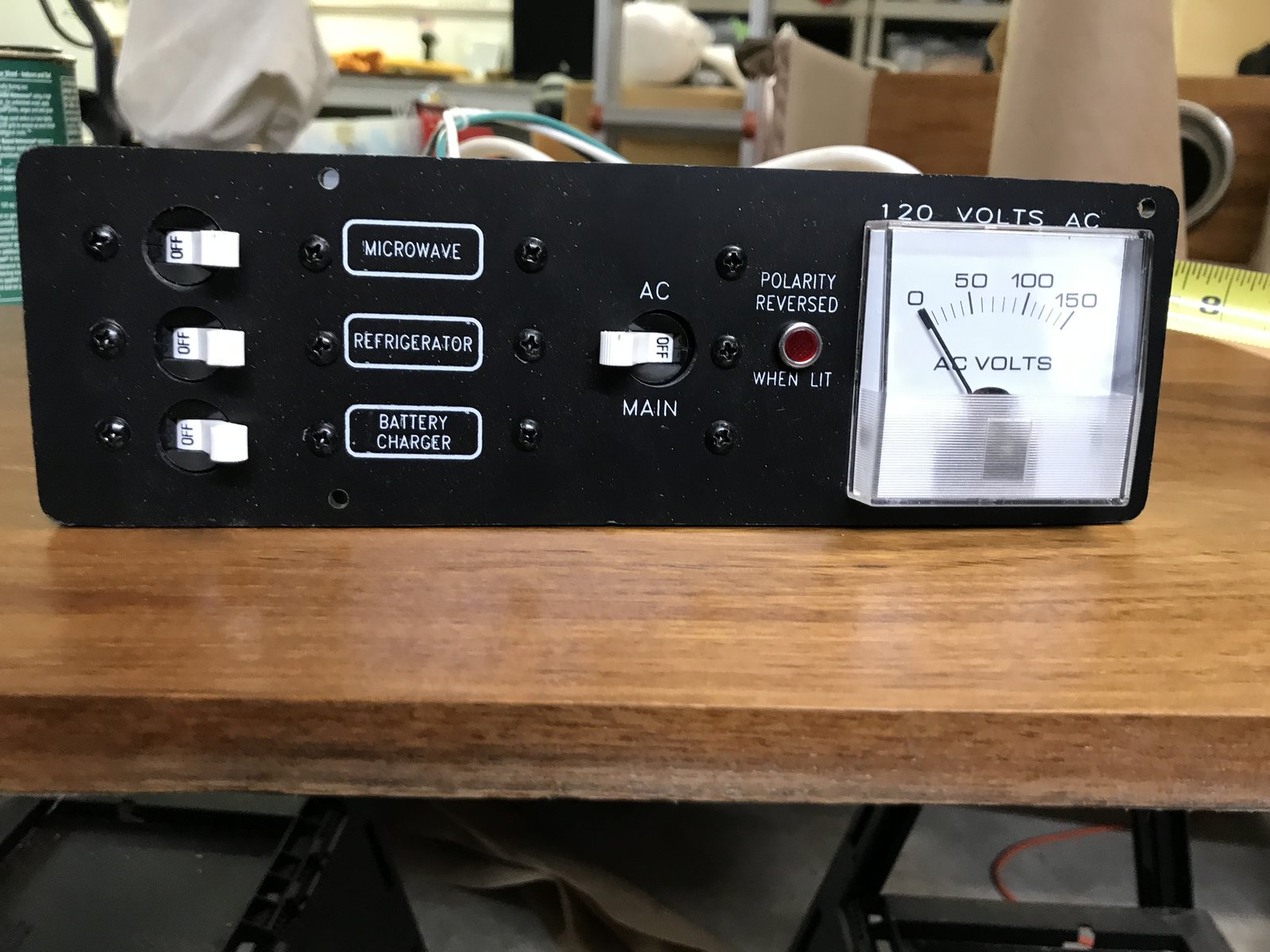

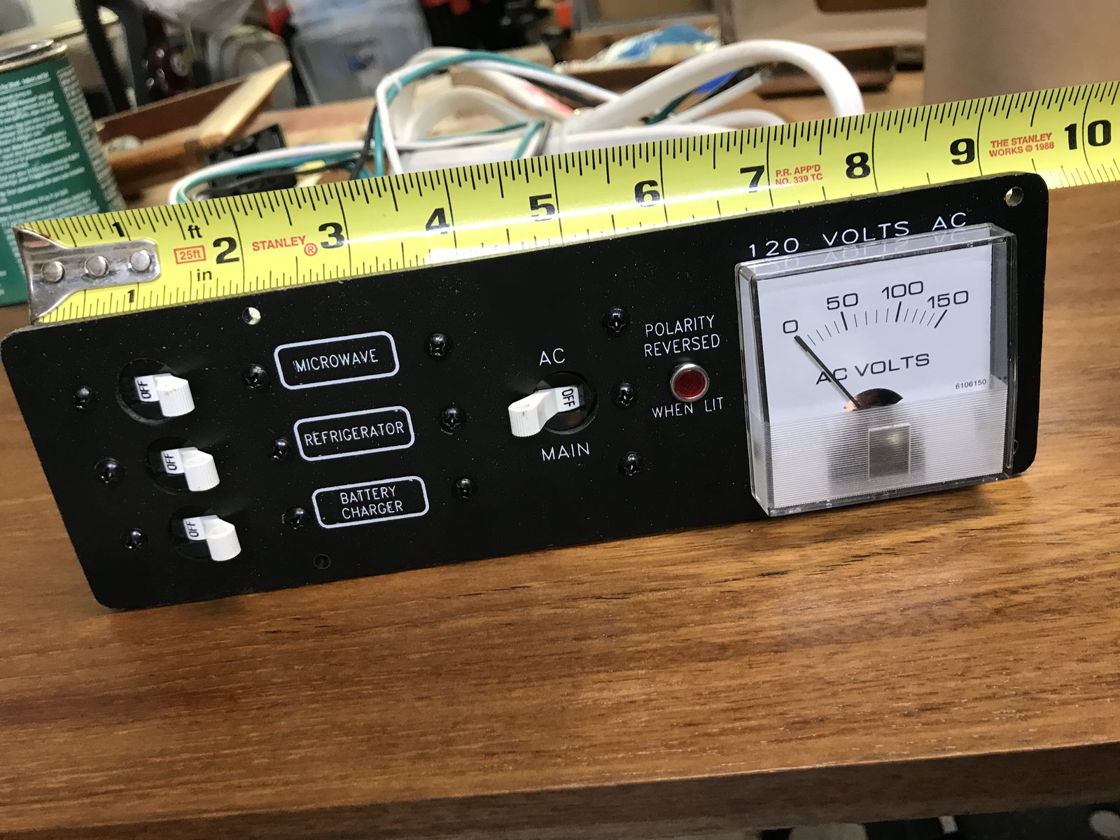

    RGT I found the panel. My 52' MY that I bought a few years back did not have air conditioning. I was going to install it and I was going to need a 2nd 30 amp panel dedicated to the AC unit. I found this on eBay and bought it for the task. I sold that boat before I ever put the AC in. IMG_0399[1].JPG IMG_0400[1].JPG IMG_0401[1].JPG
    The Main Breaker is rated at 30 amp. The breakers labeled Microwave, Refrigerator and Battery Charger are rated, 15 amp, 7.5 amp and 10 amp respectively. It measures 9 5/8" wide and 3" high. Its prewired and I think it's new.
    For what you are describing you want to do I think this would work perfectly for you. Give me $50 and pay the shipping and it's yours.
    Let me know. I'll give you first shot at it and if you or someone else doesn't want it it's going on eBay for $100. However, if you buy and install it we want pictures.
